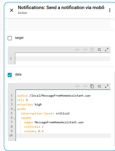

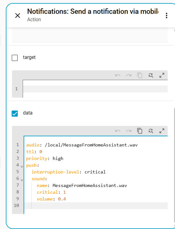

Guys, is working both on Apple Watch and Iphone even when locked. But you should put both entries like below. The wav file must be in root of www
actions:
  • action: notify.mobile_app_cristi_iphone
    message: Smoke test
    audio: “/local/MessageFromHomeAssistant.wav”
    ttl: 0
    priority: high
    push:
    interruption-level: critical # <— ASTA lipsește pentru ecran blocat
    sound:
    critical: 1
    volume: .4
This would be awesome if I can get this to work. However I don’t understand what you mean by, “the wave file must be in root of www”. Where is that location, on my iphone somewhere?
