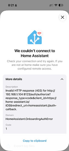

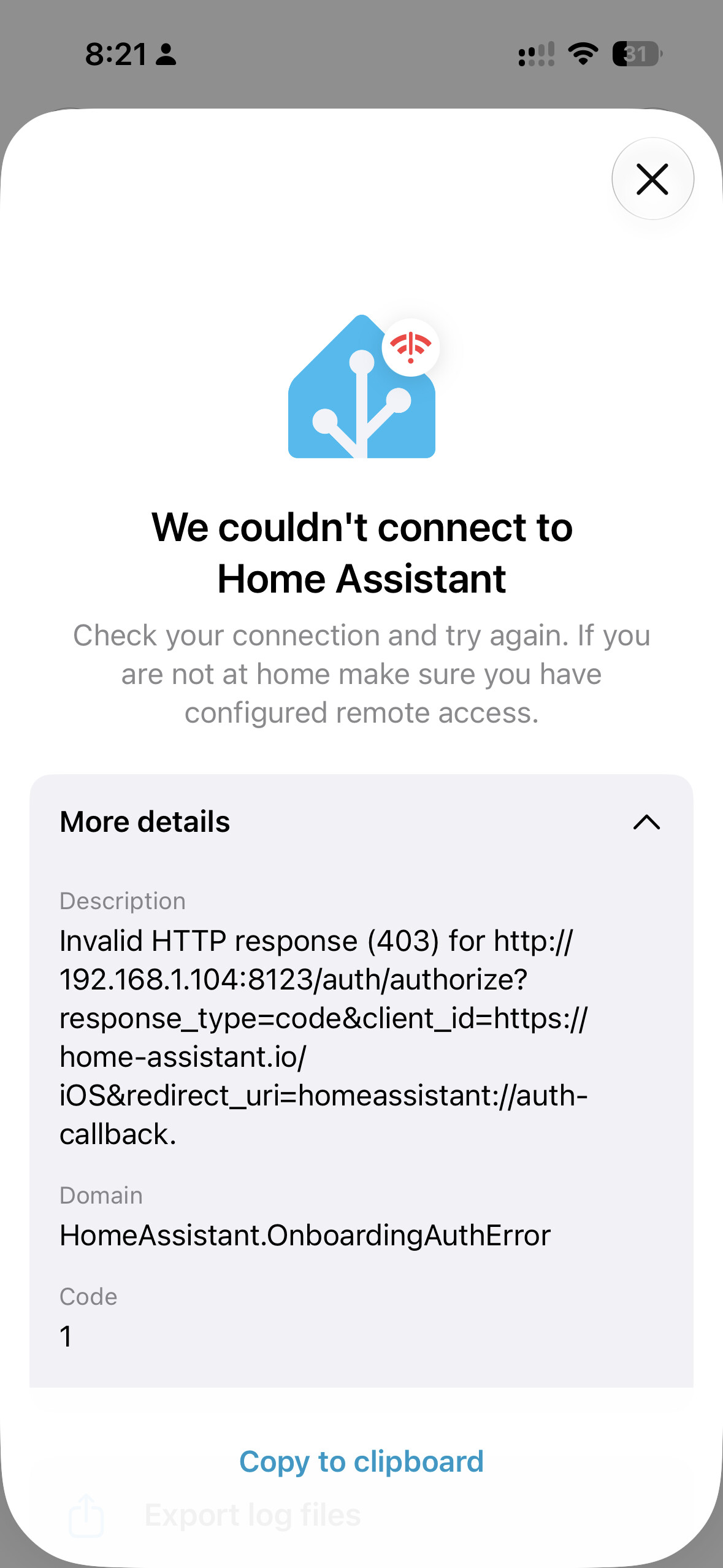

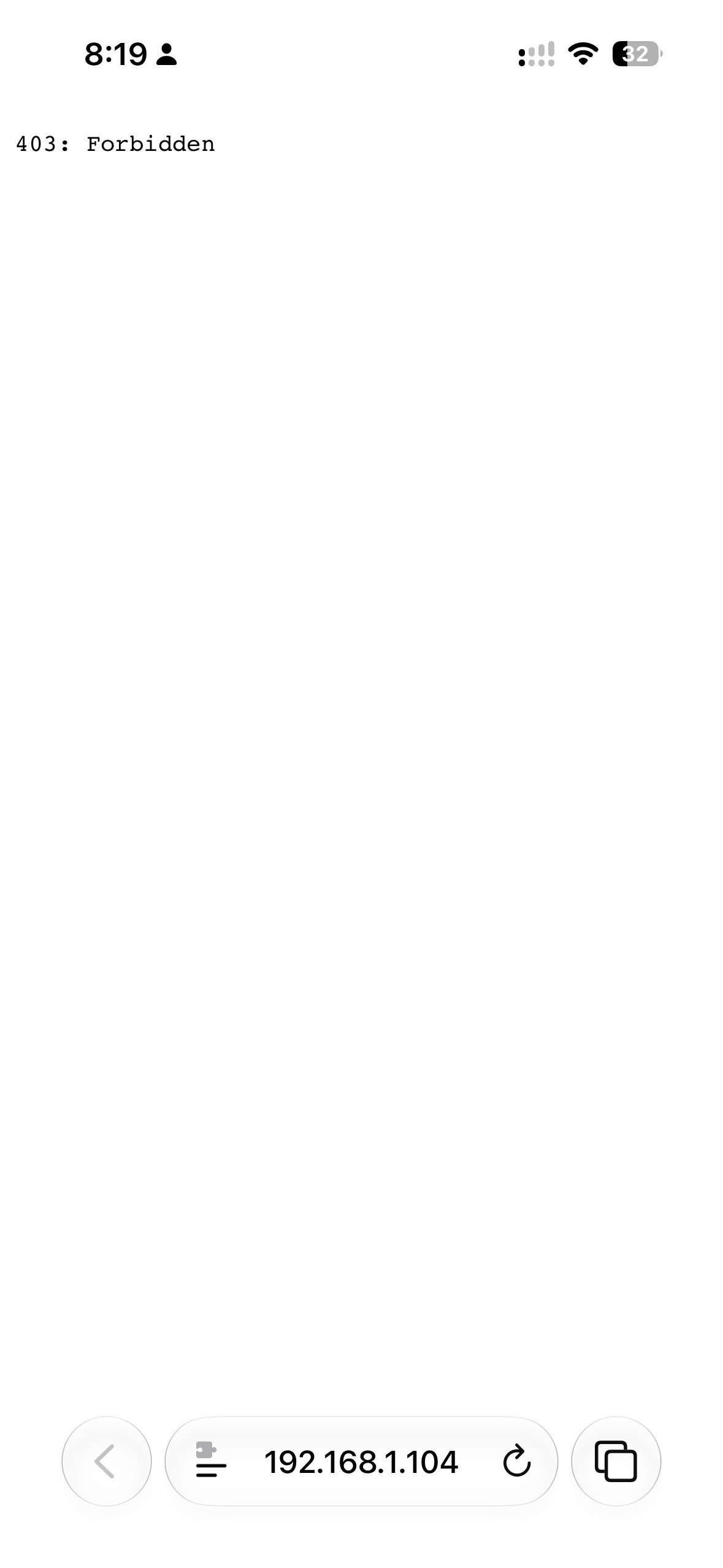

Anyone else unable to connect to Home Assistant via the mobile app or Safari on iOS 27 Beta?
I get a 403 error via Safari etc.

Bizarre! It worked fine before upgrading to iOS 27.
You've been banned out (too many wrong passwords) ? Did you check "ip_bans.yaml"?(from another device)
Good point, I’m not sure why it did that, I forced an IP change and it worked again.
How did you force the ip change and on what device?
I’m also experiencing the 403’s and can’t login on the actual public beta of iOS 27 with the home assistant app.
