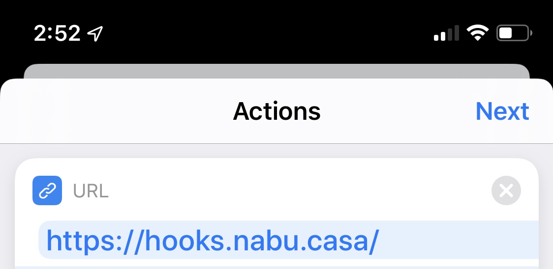

I just figured this out today using the IOS shortcuts app. Here’s what my actions looks like it’s just a URL and a get content from URL

How does this works with URL actually?
Didn’t know you could just post any command via webhook without an automation on Hassio.
Could you explain like I’m 5? :smile:

automation:
    platform: event
    event_type: ifttt_webhook_received
    event_data:
      action: call_service
    service_template: '{{ trigger.event.data.service }}'
    data_template:
      entity_id: '{{ trigger.event.data.entity_id }}'
The URL is just and address to send the JSON Post message. this is the automation i use for all of my webhooks. IFTTT and otherwise. basically the json data that we enter falls into the templates and tells it what to do.
