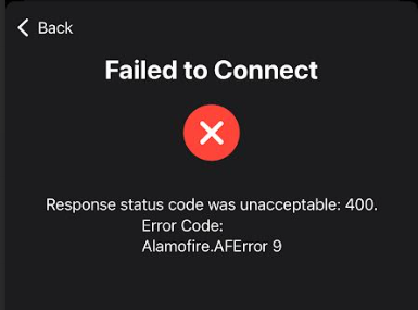

Suddenly my iOS Home Assistant App cannot connect to my server anymore. Anyone has the same issue?
My server:
Home Assistant OS 9.2
|Supervisor Version|supervisor-2022.10.0|
|Docker Version|20.10.17|
The iOS app:
  • cannot find local server, i must add server manually.
  • ios app redirected to the login page to verify user.
  • verify username and password successfully, the app go back to its interface
  • app checking something, then fail notification. Shared.WebhookError 3
    I’ve included screen shot and log below.

I’ve tried:
  • re-install the ios app > Failed.
  • removed all devices: Configuration>Integration>Mobile>deleted all. Try ios app connect again. > Failed
    Every time I try to connect, server successfully registered the device. I think something’s wrong with mobile integration.
  • update Hassio to latest 9.2. Try ios app connect again > Failed
It looks like the get_config webhook call from the app is failing and returning no data. Check your HA server logs to see if there’s anything there related to the mobile_app integration or a webhook error.
Found this log after fail connecting the app.
I think there’s something wrong with the mobile_app components, encryption error.
I remember did not install this component, it’s default.
I should try to find the source of this components, reinstall and retry.

I had the exact same symptoms under Home Assistant Core 2025.2.5.
I updated to 2025.3.4 and it switched to
Response status code was unacceptable: 400.
Error code:
Alamofire.AFError 9

I have gotten past this one small step, but get stopped by Shared.WebhookError 3.
Before getting the server to show up in the list, I turned off ipv6 in Settings > System > Network, added default_config: to configuration.yaml, and rebooted the system.
I turned ipv6 back on and it still shows in the server list, but has gone back to Alamofire.AFError 9.
