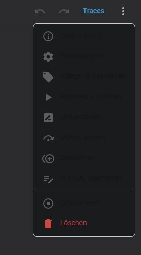

In Frontend version 20260107.2 and HA 2026.1.3, I started getting dark on dark text in the dropdown menu when editing automations.
Adding this to the theme yaml fixed it:
  # Web Awesome (wa-*) text colors
  wa-color-text-normal: var(--primary-text-color)
  wa-color-text-quiet: var(--secondary-text-color)
  # Dropdown / context menu background
  wa-color-neutral-fill-normal: "#474747"
  # Dropdown / context menu icon color
  ha-color-on-neutral-normal: "#8f8f8f"

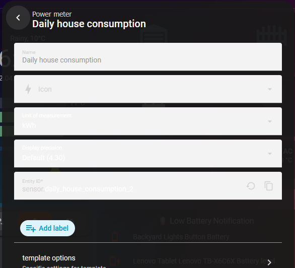

Hi, I get these white boxes for dark themes and I cannot change them into something visible, I tried all the AI’s until they gave up :slight_smile:
Can someone help me with these?
Fixed the “white on white” issue on iOS dark mode.
It works perfectly now, enjoy. :+1:
Moved these to the very bottom.
!!! Remove the paper-dialog-background-color line !!!
NEW VARIABLES FOR HA 2026.4 (fixes “white on white” in menus)
ha-color-form-background: “var(–primary-background-color)”
ha-color-form-background-hover: “rgba(255, 255, 255, 0.1)”
ha-color-form-background-disabled: “var(–disabled-text-color)”

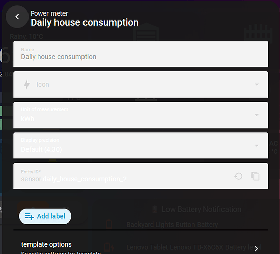

That fixed not all btw…
This did not correct everything in color, the most basic thing became better and better and more beautiful.
Together, maybe someone else can help.
I found a few more fixes, give them a try.
Buttons, badges, statuses
ha-color-fill-primary-normal-resting: “var(–primary-background-color)”
ha-color-fill-primary-normal-hover: “rgba(255, 159, 9, 0.15)”
ha-color-fill-primary-normal-active: “rgba(255, 159, 9, 0.25)”
ha-color-fill-primary-normal-disabled: “var(–disabled-text-color)”
ha-color-fill-primary-quiet-resting: “var(–primary-background-color)”
ha-color-fill-primary-quiet-hover: “rgba(255, 159, 9, 0.1)”
ha-color-on-primary: “var(–primary-text-color)”
I was able to fix 98%
But not the headings for etc content…badges… layout…
On example template mushroom cards or tile cards that do have
Different options to chose from…
And i moted aswell…when adding an invalid entity…then the
Background is white too…
So yeah…not done yet!
Besides that…even the default dark theme from has has those isseus…
So i total not understand why they do bring out the new core release…while the default themes do mess up too…
Guess im to stupid…
