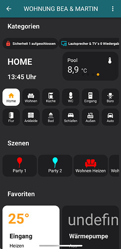

I have tried this, but it does‘nt work for me. On my Android Tablett World only the orange background, nothing else. This is how it Looks on my iPhone with the iOS Companion App.
Any solutions?
