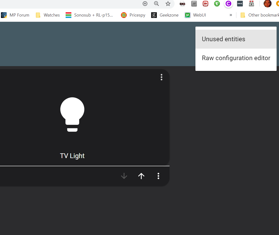

@tek0011 - you can still use GUI with a custom background.
You have to do 4 things to enable background:
Edit the ios-dark-mode.yaml and change the background image reference and the restart H.A.
background-image: 'center / cover no-repeat fixed url("/local/bluegradient.jpeg")'
Copy the image into the www folder
/config/www/bluegradient.jpeg
Check you can view the image in a web browser at your home assistant url
visit http://homeassistantserver:8123/local/bluegradient.jpeg
Use raw configuration editior in the GUI (see my above screenshot) and add
background: var(--background-image)
Thank you @kiwijunglist ! Got the background figured out, and you just helped me completely understand using local files. I was trying to figure out where the files in config/www/ are available at /local/ - I was trying to dig into apache settings, trying to figure out how it was pathing it.
Much appreciated. All is working now.
