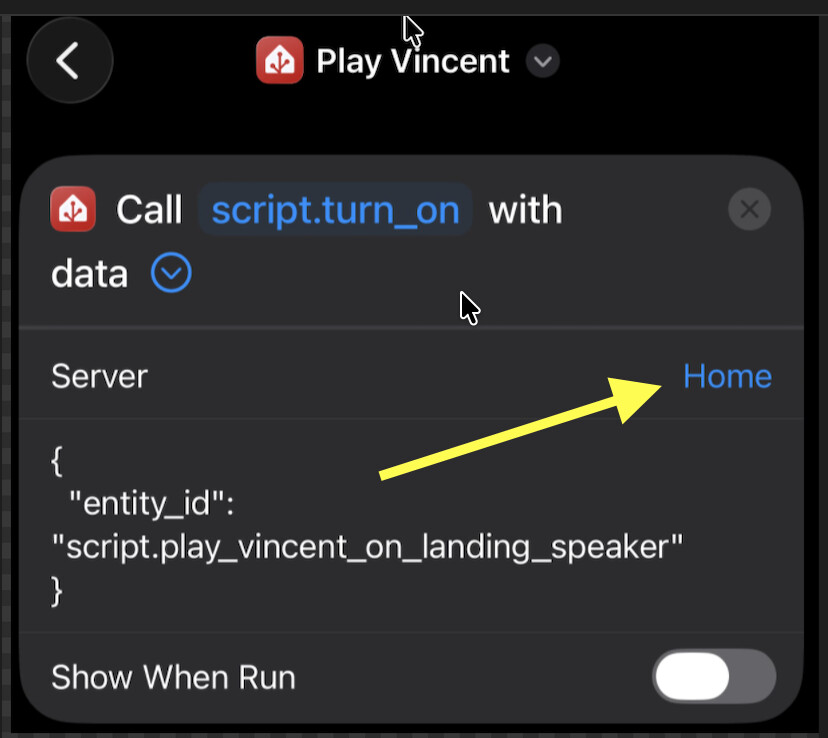

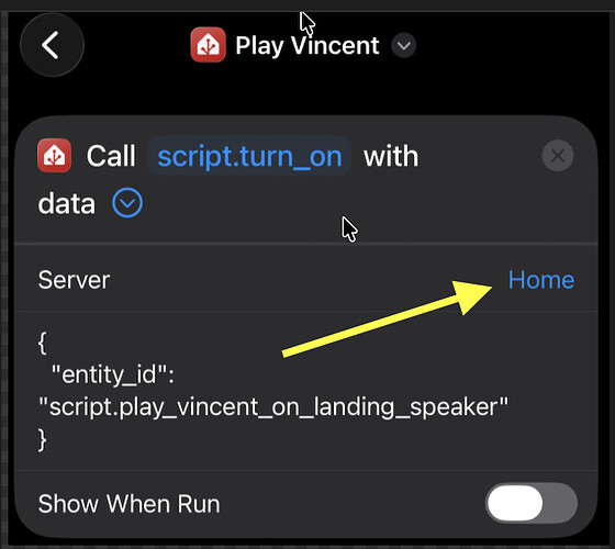

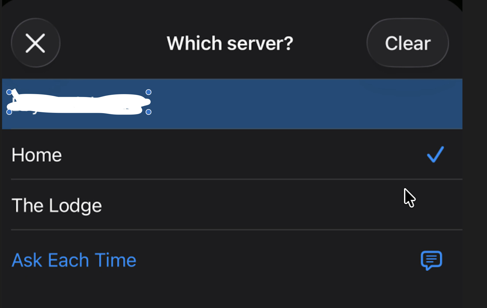

It does work now. Maybe an update fixed it. Make sure you have ‘Ask each time’ deselected.

Just tap this to select the server.
