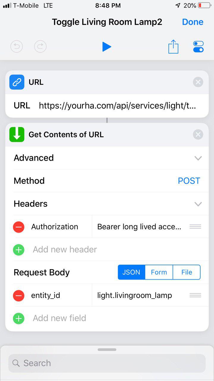

  1. Then click the search bar again and this time type in Get Contents of URL.
  2. Once you have the new block added click Adavnced and change the Method type to POST.
  3. After that click on Headers and add a new header.
  4. Change the name of the key block to Authorization
  5. Change the name of the text block to Bearer your long-lived access token
Example:
Bearer eyJ0eXAiOiJKV1QiLCJhbGciOiJIUzI1NiJ9.eyJpc3MiOiIwMTg1blahblahblah
  1. Then in the Request Body click add new field and select text.
  2. Change the name of the key block to entity_id
  3. Change the name of the text block to match the name of the light you would like to toggle.

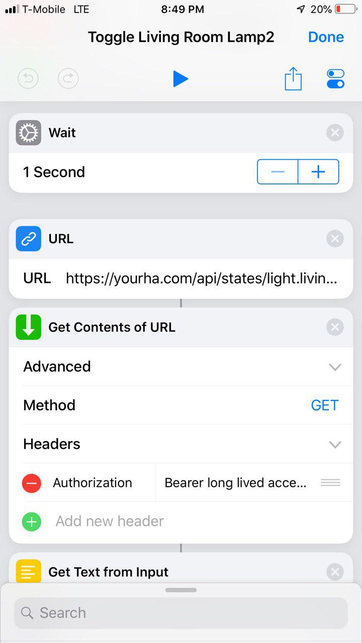

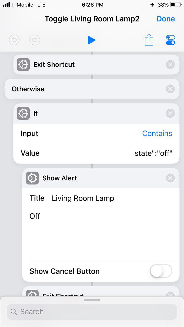

Receiving the state of an entity
Follow these screenshots if you would like to also receive the state of the entity.
I will update this tutorial with written documentation tomorrow but for now I will just post the screenshots as at this point you should have the idea of how to do this.

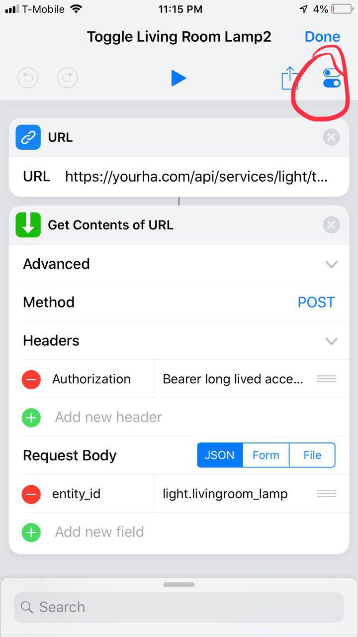

Add the shortcut to Siri or the home screen
If you would like to be able to control your new shortcut with Siri or from the home screen then click the icon at the top right and click either add to sir, add to home screen, or both.

I came across this thread while watching @DrZzs stream rewind. Instead of Get Text From Input I am using Get Dictionary Value.
Add Get Dictionary Value
Choose Value
Set Key to ‘state’.
The output I get is either on or off. Since I am getting a reliable report, I skip the If statement and display the state with Show Notification.
