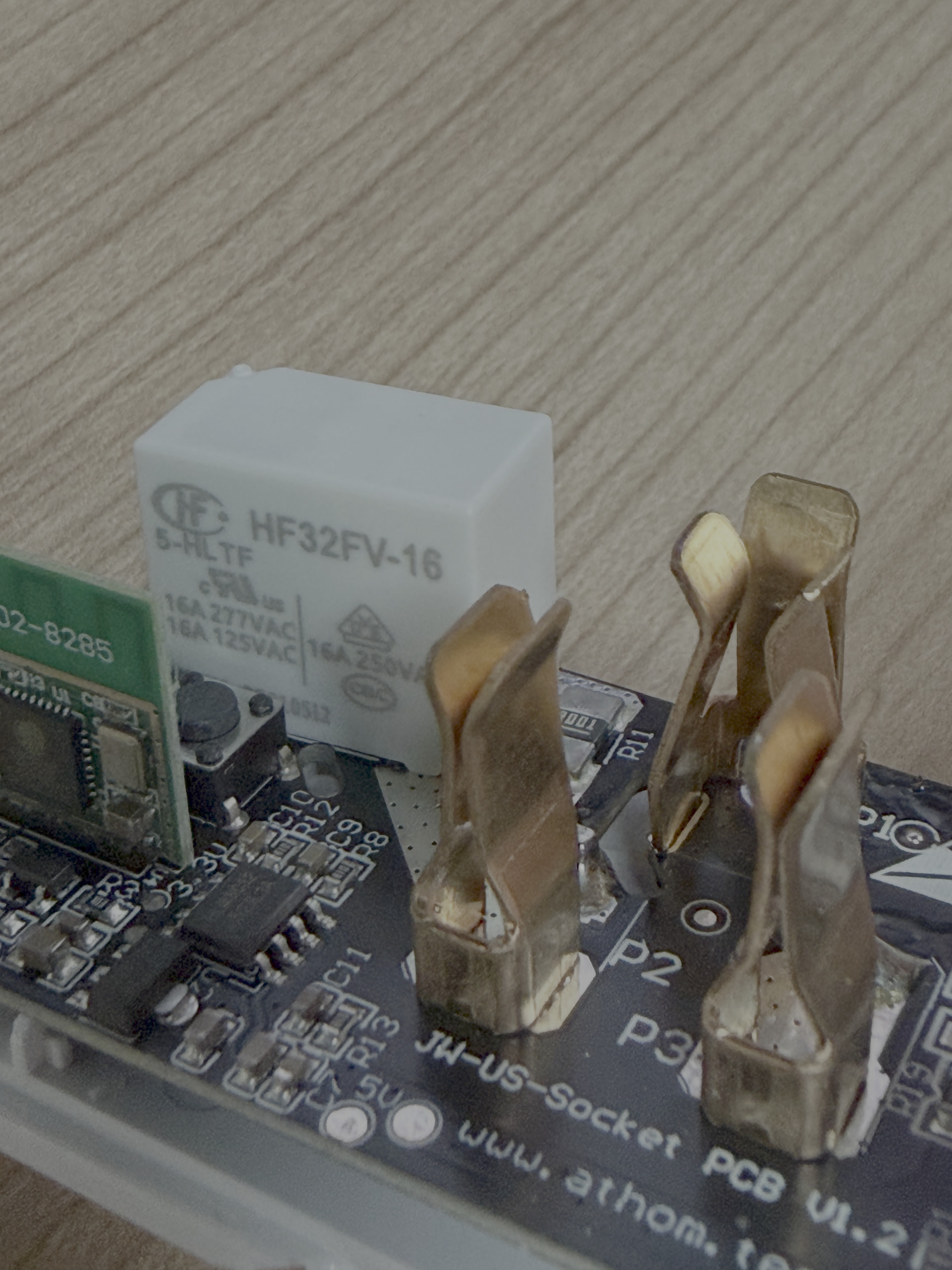

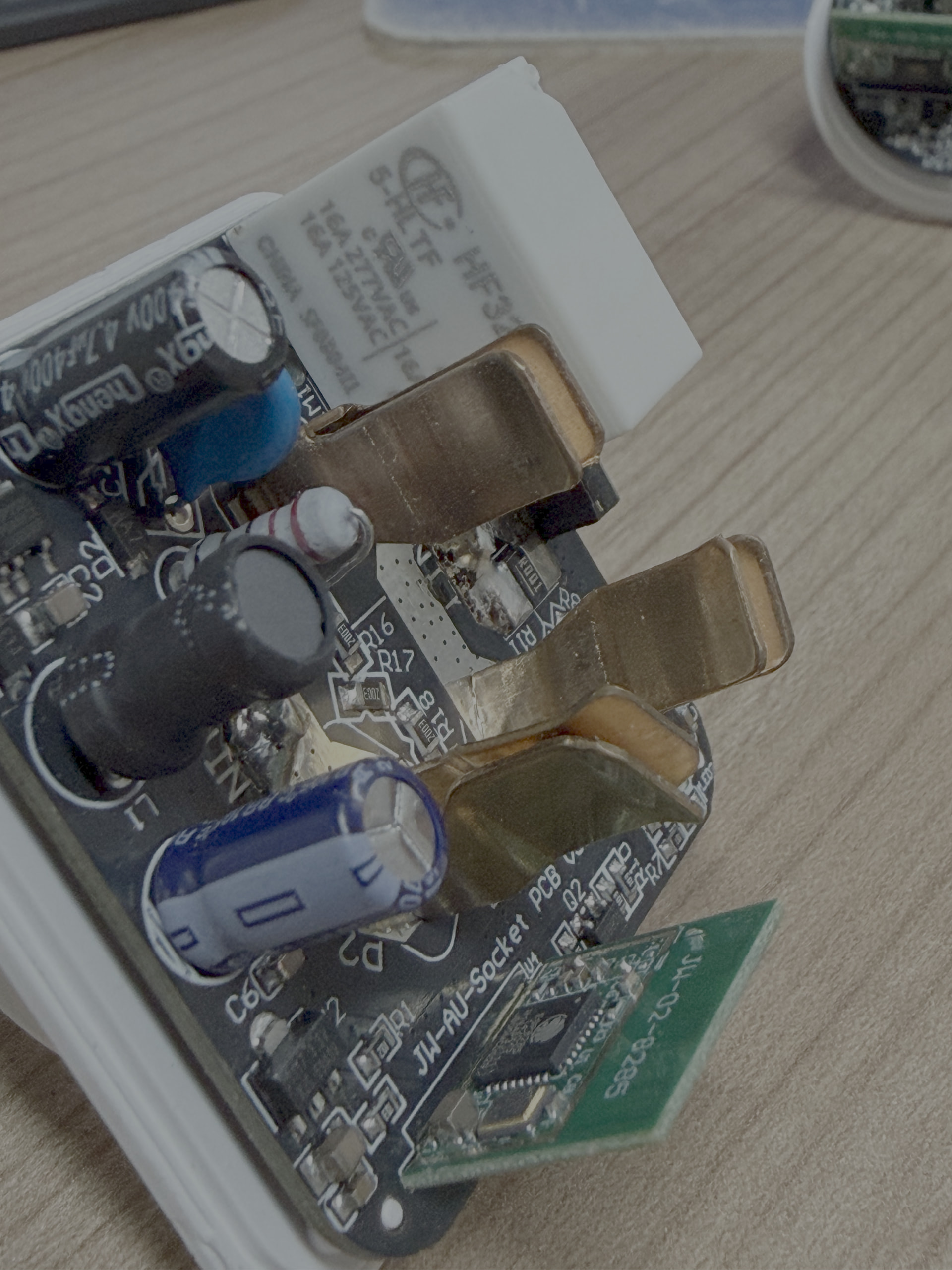

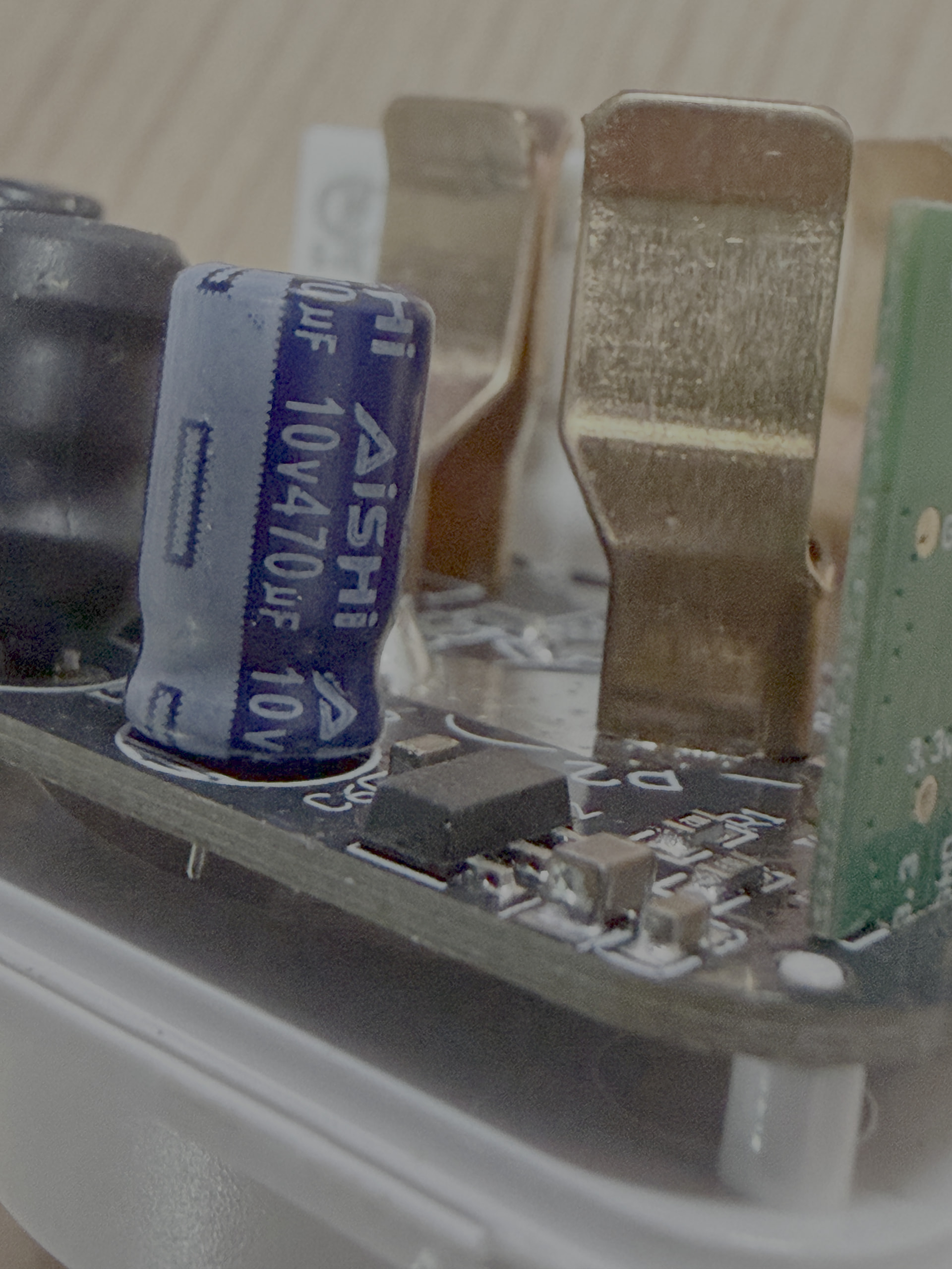

Not so sure about this. There are widespread reports of failed plugs heading to landfill after ~12months. Mileage may vary by region and plug version. I love what they do on the software side of things but there are definitely some sustainability question marks on the hardware side. Often by the time devices fail a new version is released with undemonstrated reliability, resulting in a ā€œhope-cycleā€ that newer versions don’t suffer the issues from older versions.
Statement: Since November 2024, all internal relays in the plugs have been replaced with Hongfa brand 16A relays, and the core capacitors have been replaced with Aishi brand capacitors. These two brands are considered leading brands in the industry. All have FCC, CE and UKCA certifications.
That sounds encouraging.
Can you clarify if you are referring to component or device electrical certification? I think you mean the former?
The Australian plugs do not have the relevant ANZ certification / RCM mark. It is a risk in Australia (e.g. to home insurance) to use non-certified electrical equipment.
These are electrical equipment certifications. FCC, CE, and UKCA certification all require the complete product to be submitted to a certification body for testing and approval.
