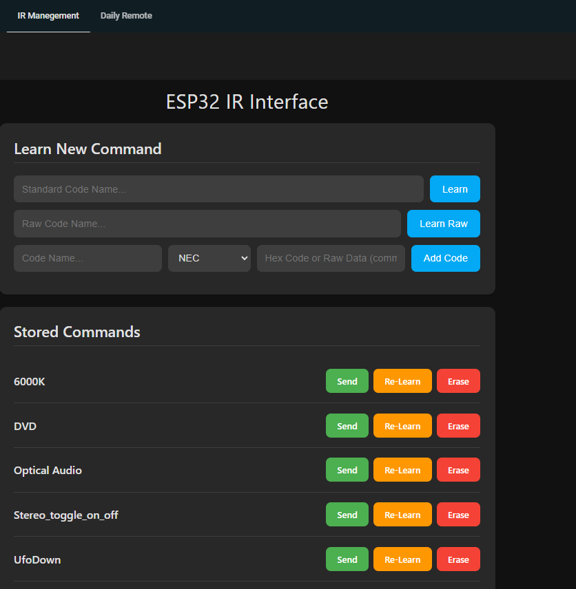

  • Web Management Interface: HA-themed dashboard to learn, send, re-learn, or erase codes with toast notifications.

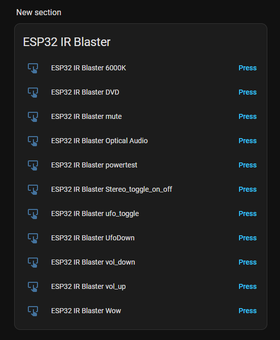

  • MQTT Auto-Discovery: Buttons appear/disappear in HA instantly—no manual config needed.
  • HA Button Integration: Control devices via HA dashboard; automate with scripts or voice assistants.

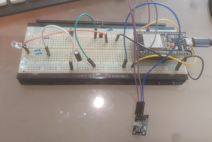

Hardware Requirements
What You’ll Need
  • ESP32 Development Board: Any ESP32 module (e.g., ESP32-WROOM-32) with Wi-Fi. Reason: Handles IR, web server, and MQTT.
  • IR Receiver (e.g., VS1838B): Connected to pin 21 for learning codes. Reason: Captures IR signals from remotes.
  • IR LED (Transmitter): Connected to pin 27 for sending codes. Use a high-power IR LED for range. Reason: Emits IR signals.
  • Resistors and Breadboard: 220Ω resistor for IR LED; jumper wires. Reason: Protects components and aids prototyping.
  • Power Supply: USB cable or 5V adapter for ESP32.
Optional: Enclosure; transistor (e.g., 2N2222) to boost IR LED power.
Note: Position IR receiver and transmitter to face devices/remotes effectively.

Wire the Hardware
  • IR Receiver: Signal to pin 21, VCC to 3.3V, GND to GND.
  • IR LED: Anode to pin 27 via 220Ω resistor, Cathode to GND.

Add HA Dashboard CardCreate a new card in your HA dashboard to display IR buttons dynamically:
yaml
type: custom:auto-entities
card:
type: entities
title: ESP32 IR Blaster
show_header_toggle: false
filter:
include:
- entity_id: button.esp32_ir_blaster_*
sort:
method: friendly_name
Reasoning: The auto-entities card uses MQTT auto-discovery to list IR buttons (e.g., button.esp32_ir_blaster_pioneer_xv_dv55_on) sorted by name, updating automatically.Embed Web Interface in HA

Usage Instructions<details> <summary><b>How to Use</b></summary> Learning and Managing Codes
* Access the web interface (http://ESP32-IP) or embedded in HA.
* Use "Learn" or "Learn Raw" forms to capture codes from a remote using the IR receiver.
* Use "Add Code" to manually enter hex or raw data (e.g., for discrete On/Off).
* Send, Re-Learn, or Erase codes from the "Stored Commands" list.
Controlling in HA
* Buttons appear in the "ESP32 IR Blaster" card in HA.
* Click to send IR commands.
* Automate via HA scripts, scenes, or voice assistants (e.g., Google Home).

void publishMqttDiscovery() {
    Serial.println("Publishing MQTT Discovery messages for all buttons...");
    for (const auto& code : learnedCodes) {
        String object_id = sanitizeForMqtt(code.name);
        String configTopic = "homeassistant/button/" + String(mqtt_client_id) + "/" + object_id + "/config";
        StaticJsonDocument<512> doc;
        doc["name"] = code.name;
        doc["unique_id"] = String(mqtt_client_id) + "_" + object_id;
        doc["command_topic"] = mqtt_command_topic;
        doc["payload_press"] = code.name;
        doc["availability_topic"] = mqtt_status_topic;
        JsonObject device = doc.createNestedObject("device");
        device["identifiers"] = mqtt_client_id;
        device["name"] = "ESP32 IR Blaster";
        device["manufacturer"] = "Espressif";
        device["model"] = "ESP32-WROOM-32";
        device["sw_version"] = "10.3-HA-Theme-Final";
        String jsonBuffer;
        serializeJson(doc, jsonBuffer);
        mqttClient.publish(configTopic.c_str(), jsonBuffer.c_str(), true);
    Serial.println("MQTT Discovery messages published.");

void handleRoot() {
  String page = R"=====(
<!DOCTYPE html>
<html>
<head>
    <title>ESP32 IR INTERFACE</title>
    <meta name='viewport' content='width=device-width, initial-scale=1'>
    <style>
        :root {
            --ha-background: #111111; --ha-card-background: #282828; --ha-primary-text-color: #E1E1E1; --ha-secondary-text-color: #9B9B9B;
            --ha-accent-color: #03A9F4; --ha-green-color: #4CAF50; --ha-amber-color: #FF9800; --ha-red-color: #F44336;
            --ha-border-color: #3E3E3E; --ha-input-fill-color: #3E3E3E;
        body { font-family: -apple-system, BlinkMacSystemFont, "Segoe UI", Roboto, sans-serif; background-color: var(--ha-background); color: var(--ha-primary-text-color); margin: 0; padding: 12px; }
        .container { max-width: 800px; margin: auto; }
        .card { background-color: var(--ha-card-background); border-radius: 12px; padding: 24px; margin-bottom: 20px; box-shadow: 0 2px 4px rgba(0,0,0,0.2); }
        header { text-align: center; padding-bottom: 16px; }
        header h1 { margin: 0; font-weight: 400; letter-spacing: 0.5px; }
        h2 { font-weight: 500; letter-spacing: 0.2px; padding-bottom: 8px; border-bottom: 1px solid var(--ha-border-color); margin-top: 0; }
        .learn-section form { display: flex; gap: 10px; margin-bottom: 12px; }
        .learn-section input[type='text'], .learn-section select { flex-grow: 1; padding: 12px; border: 1px solid var(--ha-border-color); border-radius: 8px; background-color: var(--ha-input-fill-color); color: var(--ha-primary-text-color); font-size: 1em; }
        .learn-section input[type='submit'] { padding: 12px 20px; border: none; background-color: var(--ha-accent-color); color: white; border-radius: 8px; cursor: pointer; font-size: 1em; font-weight: 500; }
        .code-list { list-style: none; padding: 0; }
        .code-item { display: flex; justify-content: space-between; align-items: center; padding: 16px 0; border-bottom: 1px solid var(--ha-border-color); }
        .code-item:last-child { border-bottom: none; }
        .code-details .code-name { font-weight: 500; font-size: 1.1em; }
        .actions { display: flex; align-items: center; gap: 8px; }
        .actions a { text-decoration: none; padding: 10px 18px; color: white; border-radius: 8px; font-size: 0.9em; font-weight: 500; white-space: nowrap; text-align: center; }
        .send-btn { background-color: var(--ha-green-color); }
        .relearn-btn { background-color: var(--ha-amber-color); }
        .erase-btn { background-color: var(--ha-red-color); }
        #toast { display: none; position: fixed; top: 20px; left: 50%; transform: translateX(-50%); padding: 16px 32px; border-radius: 12px; color: white; font-size: 1.2em; font-weight: 500; z-index: 1000; box-shadow: 0 4px 8px rgba(0,0,0,0.3); }
        #toast.success { background-color: var(--ha-green-color); }
        #toast.fail { background-color: var(--ha-red-color); }
        #toast.learn { background-color: var(--ha-accent-color); }
        @media (max-width: 600px) {
            body { padding: 8px; } .card { padding: 16px; } .code-item { flex-direction: column; align-items: stretch; gap: 15px; }
            .actions { flex-direction: row; justify-content: space-around; width: 100%;} .actions a { flex-grow: 1; }
    </style>
</head>
<body>
    <div class='container'>
        <header><h1>ESP32 IR Interface</h1></header>
        <div class="card">
            <h2>Learn New Command</h2>
            <div class='learn-section'>
                <form id='learnForm' action='/learn' method='POST'>
                    <input type='text' name='name' placeholder='Standard Code Name...' required>
                    <input type='submit' value='Learn'>
                </form>
                <form id='learnRawForm' action='/learnraw' method='POST'>
                    <input type='text' name='name' placeholder='Raw Code Name...' required>
                    <input type='submit' value='Learn Raw'>
                </form>
                <form id='addForm' action='/add' method='POST'>
                    <input type='text' name='name' placeholder='Code Name...' required>
                    <select name='protocol' required>
                        <option value='NEC'>NEC</option>
                        <option value='SONY'>Sony</option>
                        <option value='SAMSUNG'>Samsung</option>
                        <option value='JVC'>JVC</option>
                        <option value='UNKNOWN'>Raw</option>
                    </select>
                    <input type='text' name='code_data' placeholder='Hex Code or Raw Data (comma-separated)' required>
                    <input type='submit' value='Add Code'>
                </form>
            </div>
        </div>
        <div class="card">
            <h2>Stored Commands</h2>
            <ul class='code-list'>
  if (learnedCodes.empty()) {
    page += "<li>No codes stored. Use the forms above to learn a new command.</li>";
  } else {
    std::sort(learnedCodes.begin(), learnedCodes.end(), [](const IRCode& a, const IRCode& b){ return a.name < b.name; });
      page += "<li class='code-item'><div class='code-details'><div class='code-name'>" + code.name + "</div></div>";
      page += "<div class='actions'><a href='/send?name=" + code.name + "' class='send-btn'>Send</a><a href='/relearn?name=" + code.name + "' class='relearn-btn' onclick=\"showToast('Awaiting IR Signal...', 'learn');\">Re-Learn</a><a href='/erase?name=" + code.name + "' class='erase-btn' onclick='return confirm(\"Are you sure?\");'>Erase</a></div></li>";
  page += R"=====(
            </ul>
        </div>
    </div>
    <div id="toast"></div>
    <script>
        function showToast(message, type, duration = 2000) {
            const toast = document.getElementById("toast");
            toast.textContent = message;
            toast.className = type;
            toast.style.display = 'block';
            if (type === 'learn') {
                document.querySelector('.container').style.opacity = '0.3';
            } else {
                setTimeout(() => {
                    toast.style.display = 'none';
                    window.location.href = '/';
                }, duration);
        document.querySelectorAll('form').forEach(form => {
            form.addEventListener('submit', function() {
                showToast('Processing...', 'learn');
        window.onload = function() {
            const params = new URLSearchParams(window.location.search);
            if (params.has('status')) {
                let message = params.get('message') || '';
                if (params.get('status') === 'success') {
                    showToast(message || 'Success: Code Stored!', 'success');
                } else if (params.get('status') === 'timeout') {
                    showToast(message || 'Failure: Learning Timed Out', 'fail');
                } else if (params.get('status') === 'error') {
                    showToast(message || 'Failure: Invalid Input', 'fail');
    </script>
</body>
</html>
  server.send(200, "text/html", page);
void handleLearn() {
    if (server.hasArg("name")) {
        bool success = doLearn(server.arg("name"));
        if (success) {
            server.sendHeader("Location", "/?status=success", true);
        } else {
            server.sendHeader("Location", "/?status=timeout", true);
        server.send(302, "text/plain", "");
void handleLearnRaw() {
        bool success = doLearnRaw(server.arg("name"));
        if (success) {
        } else {
void handleSend() { if (server.hasArg("name")) { doSend(server.arg("name")); server.sendHeader("Location", "/", true); server.send(302, "text/plain", ""); } }
void handleErase() { if (server.hasArg("name")) { doErase(server.arg("name")); server.sendHeader("Location", "/", true); server.send(302, "text/plain", ""); } }
void handleRelearn() { if (server.hasArg("name")) { String name = server.arg("name"); bool isRaw = false; for (const auto& code : learnedCodes) { if (code.name.equalsIgnoreCase(name)) { if (code.protocol == UNKNOWN) { isRaw = true; } break; } } if (isRaw) { handleLearnRaw(); } else { handleLearn(); } } }
void handleNotFound() { server.send(404, "text/plain", "Not found"); }
