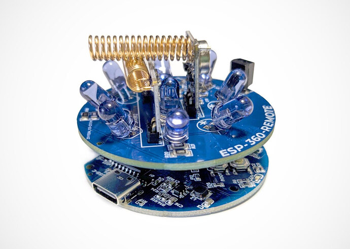

@sparkydave,
This looks good, but not clear if it provides the ability to receive IR signals. I know the table says it does, but it also says that for the RM4 Mini, and we know that’s not true.
When I follow the link to the integration at GitHub - ale1800/ESP-360-REMOTE: An all-in-one remote based on the ESP32-WROOM-32E , under “Receiving signals”, it only mentions receiving RF signals, not receiving IR signals.
