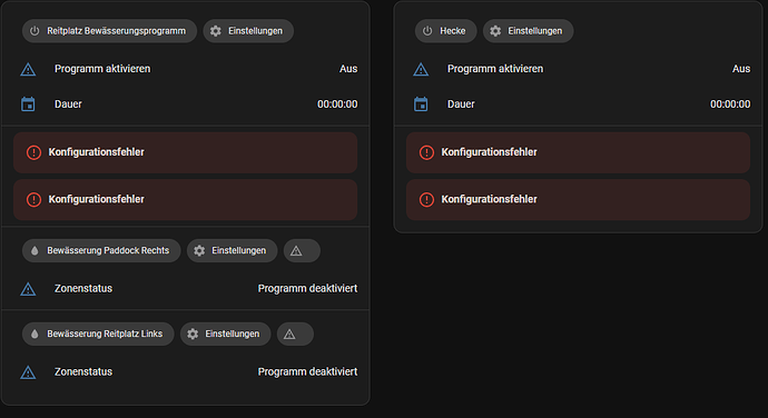

First of all, thank you for this great integration. I’m currently struggling with an annoying problem. After every restart of HA, I have several errors in the card and the automatic function cannot be operated. I can fix the errors by updating the zones and then saving them again. Then the card is displayed correctly and can be operated.
I suspect that it is due to the Sonoff switch that controls the valves. Every time I start HA, I get the following message: “switch.sonoff_4ch_tasmota4 has not initialized before the Irrigation Program, check your configuration.” Now I’m wondering what I can do. I’ve already looked for a way to delay the start of the irrigation integration, but I can’t find anything. Can anyone help me?

There is an option to delay the start, or defaults to 30 seconds it can be increased it may help with this issue.
