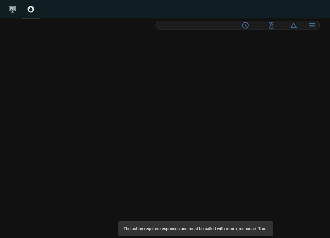

However when I try to access the Irrigation Unlimited Custom Card, I get an error on the bottom of the screen and only the very first row of icons is shown at the top:
The action requires responses and must be called with return_response=True
Occasionally after restarting Home Assistant and going back to the custom card, everything does appear to show - but it’s random and quickly falls back into showing this error.
This is what I mean:
Any thoughts?
Thanks!
It’s most likely a conflict with another integration which is using an older version of home-assistant-js-websocket. This raised it head late last year with the honey-comb-menu. See issue 22 for details on how it was traced and fixed.
Thanks! Wasn’t the honeycomb card but another one that I installed to try and get another integration working :grimacing:
Thanks again!

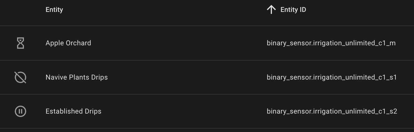

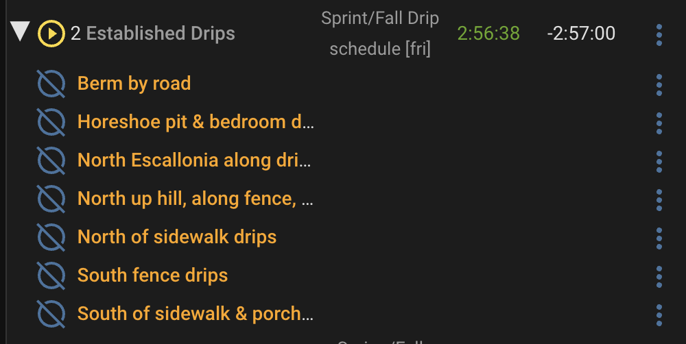

I’m still unable to cancel running sequences. I can pause a sequence, but can’t cancel. I can disable the sequence but it starts back up when enabled. Is anyone else seeing this? Same with disabling and enabling the controller.
Not being able to cancel a running sequence seems like a problem.
This action:
action: irrigation_unlimited.cancel
  entity_id: binary_sensor.irrigation_unlimited_c1_m
  sequence_id: 2
Generates this log:
2025-10-24 18:20:32] service: cancel, controller: 1, zone: 0, sequence: 0, data: {"entity_id": ["binary_sensor.irrigation_unlimited_c1_m"], "sequence_id": [2]}
But, nothing changes in the dashboard. The sequence is still paused. (I also cannot cancel if the sequence is running.)
You can see Established Drips is sequence 2:
I set a big negative adjust and even turned off every valve and it’s still just running along:
How does one cancel the running sequence? Reloading the config doesn’t reset it either.

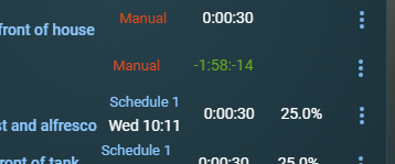

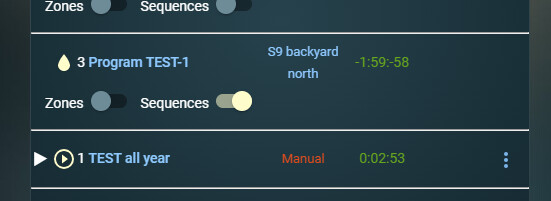

Any idea why the running time is not shown correctly?
The card has a local count down timer. If something goes wrong on the backend it will just keep counting down. It would most likely be due to the Failed to perform the action irrigation_unlimited/cancel. unsupported operand type(s) for -: ‘NoneType’ and ‘datetime.datetime’ message.
I suggest opening an issue. Please include the configuration and especially the log which will be key to solving the problem.
I haven’t seen it happening again since I finalised my setup. For testing I had multiple controllers with overlapping running times but in my final yaml version there is only one controller. I’ll open an issue if I see it happening again.

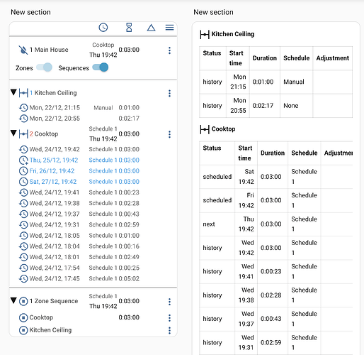

Okay I feel like I must be missing something very basic.
I’ve got the integration installed and it seems to be loaded up, but not matter what I do I can’t seem to get a schedule for the first zone listed in the config recognised. I’ve stripped it back to the most basic config to get it working but no matter won’t it won’t turn on a switch. I’ve even gone back to turning on a pre-existing light switch in the house in case it was something weird about the tap switch I newly acquired.
I also thought that maybe it was that schedules were required for some reason, so also tried the most rudimentary of schedule configs, and that revealed to me that the second zone will work, but not the first? The history and recorder things seem to be loading, as does integration_unlimited itself, just no zone 1 switches ever activate.
Various configs and logs follow. Help?
Very basic config (no work, as only one zone?)

I even tried reordering, or naming the zone_ids, but it doesn’t seem to change anything. Essentially whichever zone is first in the yaml never gets a schedule. Like this:
irrigation_unlimited:
  controllers:
    - name: "Main House"
      all_zones_config:
        show:
          timeline: true
      zones:
        - name: "Kitchen Ceiling"
          zone_id: "kitchen_ceiling"
          entity_id: "light.kitchen_ceiling"
          show:
            timeline: true
          enabled: true
        - name: "Cooktop"
          zone_id: "cooktop"
          entity_id: "switch.shellyplus1pm_xxxxxxxx_switch_0"
          show:
            timeline: true
          enabled: true
      sequences:
        - name: "Zone Sequence"
          enabled: true
          # delay: "00:01"  # Optional delay between zones, here set to 1 minute
          schedules:
            - time: "19:42" # Start time for the sequence (both zones)
          zones:
            - zone_id: "cooktop"
              duration: "00:03"
            - zone_id: "kitchen_ceiling"
              duration: "00:02"
So curious :slight_smile:
Quite possibly there is a zero adjustment in play on zone 1 - I can’t see this unless the log is from boot up. Zone 2 started straight away after the controller went on, it never attempted to start zone 1.
Reset all the adjustments, the easiest way to this is to reset on the controller level. This is a magic reset that will reset all adjustments on zones, sequences and sequence zones.
Magic reset did it. I suspect it’s because when I first had a crack at setting it up, I included the esp32 sample block, which before I’d understood it properly had already “erased” my first round of watering. Then I couldn’t get it back because the amendment persisted somehow? Even through a reinstall?
Anyway, thanks for the extension and the great community support. :potted_plant:
