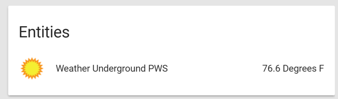

I rearranged things to make it a sensor platform rather than a component. The good news is that the icons from WUnderground now work! The bad news is that I can’t figure out how (if it’s even possible) to display the other sensor data, because it’s set up as being an attribute for the PWS. I could register a whole bunch of separate sensors like I did before, but @balloob said in the weather component pull request that it makes more sense to have one device with a bunch of attributes for the weather. So for now I’m guessing most folks will want to stick with the old version of the code, but I’m happy to push up the newer platform version if anyone wants to poke at it.
