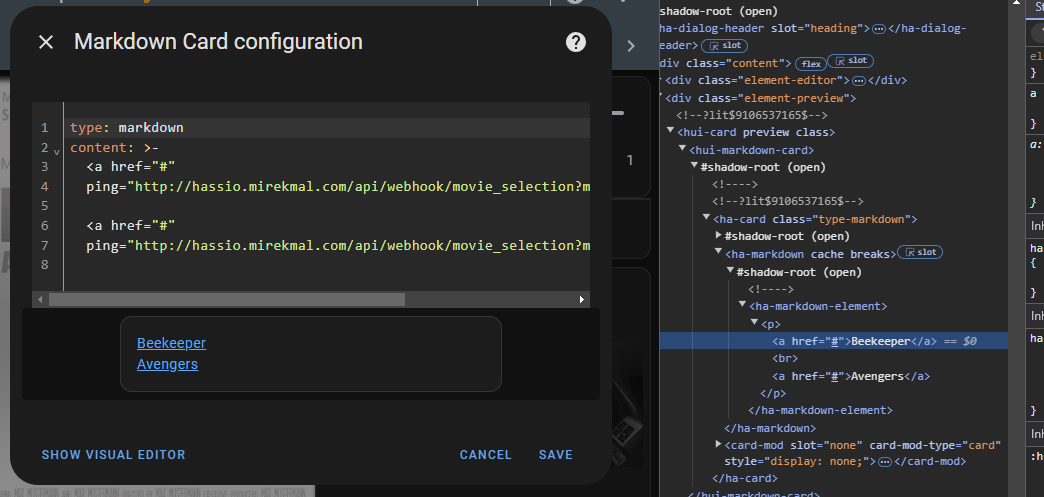

When I inspect the page with this specific link I can see that ping attribute is striped away and only href and link name are kept:

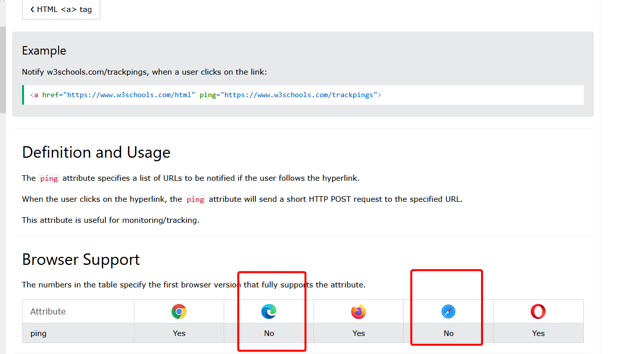

All those browsers don’t support ping. It’s only supported in chrome and firefox.
Although I’m seeing conficting results when searching the net on that.
This would explain the problem, but it is not what I’ve seen:
Thats why I went into this direction, when I found this here.
Anyhow, just for being sure I installed Chrome and it does not work either. Also inspector shows lack of ping attribute in rendered code:
