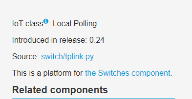

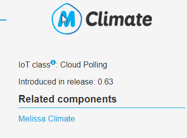

Look at the device’s iot class on the website: https://www.home-assistant.io/blog/2016/02/12/classifying-the-internet-of-things/#classifiers
Got it, thank you very much! So IoT is the key, now I see.
Then I have to find a replacement for Melissa, it’s not easy, but may be possible.
