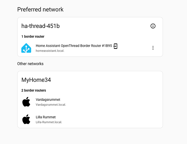

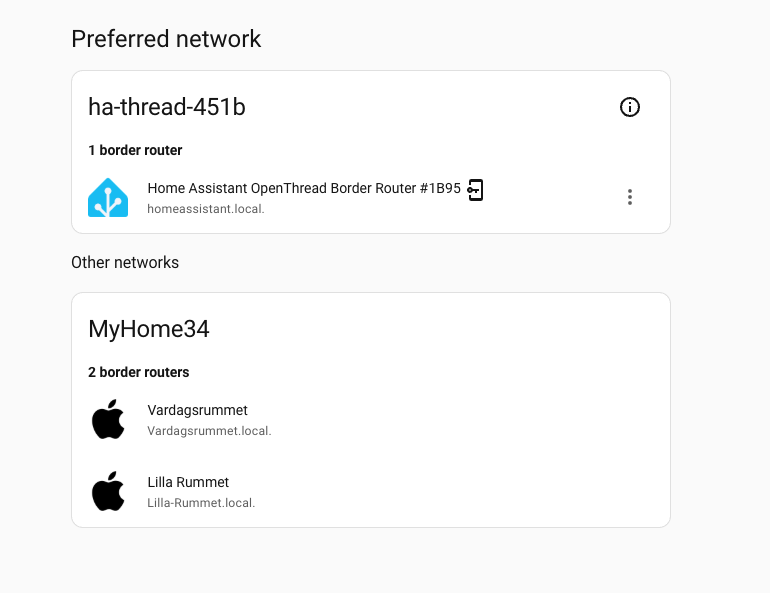

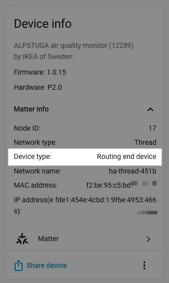

Thanks! Your second screenshot confirms it’s a router. Note however that routers are not necessarly also border routers, so an ALPSTUGA won’t show up in your first screenshot.

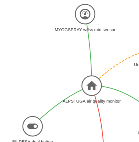

where did you get this network map?
Settings → Add-ons (I’m on 2026.1.3) → Matter Server (I’m on version 8.2.2, and have the “Use latest beta version” toggle turned on in the Configuration tab) → Open web UI → Thread (in the upper right)
Alpstuga acts as a router inside the thread / matter network, so it helps to extend the range of the network. If you have multiple Alpstugas, or other deviced which act as router, such as most light bulbs, this also increases the stability of the thread / matter network as messages can be routed over multiple paths between devices.
Alpstuga however does not act as border router, which connects the thread / matter network to ethernet, to connect with your computer or raspberry on which home assistant runs.
Most other sensors, especially those which are battery powered, don’t act as router. They only act as end device, connecting to devices acting as routers, or directly to the border router.

How do you see this graphical connection view?
