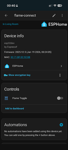

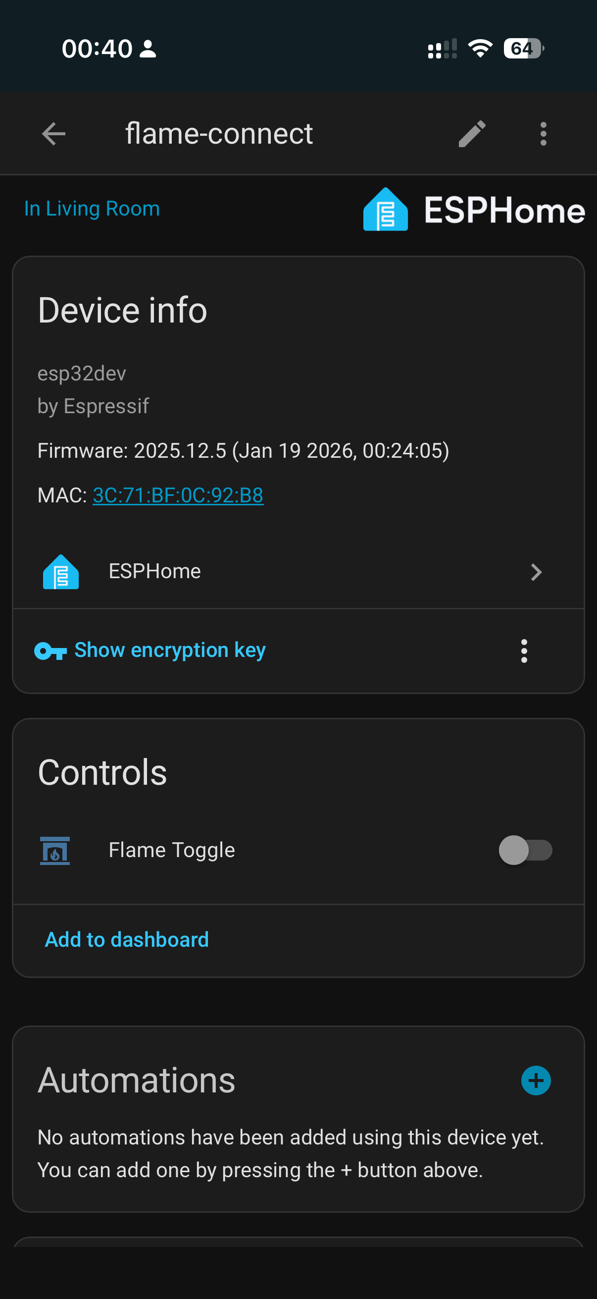

I’ve just managed to turn my Dimplex fireplace (in my case an e-Slim) on and off from Home Assistant. (Other settings are possible to implement, but not my priority right now).
It emulates the behaviour of the Flame Connect app, so should work with any Flame Connect compatible fireplace. I still need to make a few stability improvements and will share the source code afterward.
Since it uses Bluetooth it requires an ESP32 microcontroller running ESPHome.
This is the ESPHome code. It is very quick and dirty, but it works
