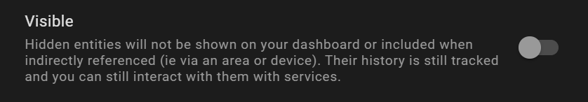

Setting the switch to hidden should avoid it being toggled if it’s part of an area:
Annoyingly, it seems this setting will still allow you to add the entity to a switch group.
Spiro’s right in saying you really shouldn’t be adding them to a group in the first place, but maybe excluding hidden entities from groups too should be the aim of any potential FR.
