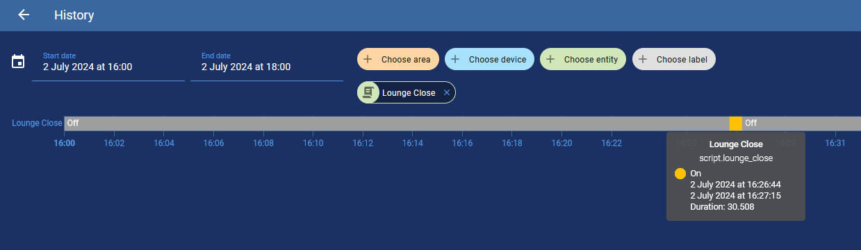

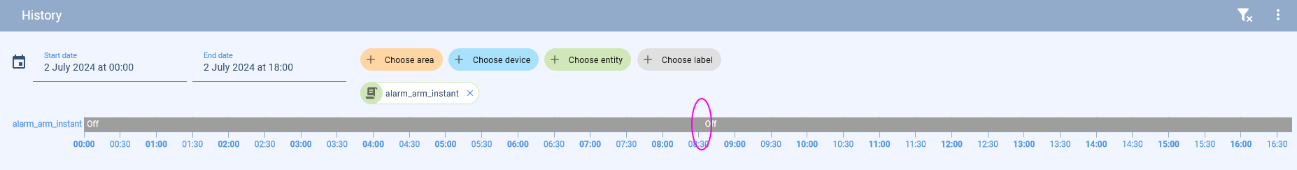

No, you do not set the sate of the script. It turns itself on when running. If you have no delays or loops in your script it will run and complete very quickly. If you look closely at the history graph for the script you will see this sliver of a state change:

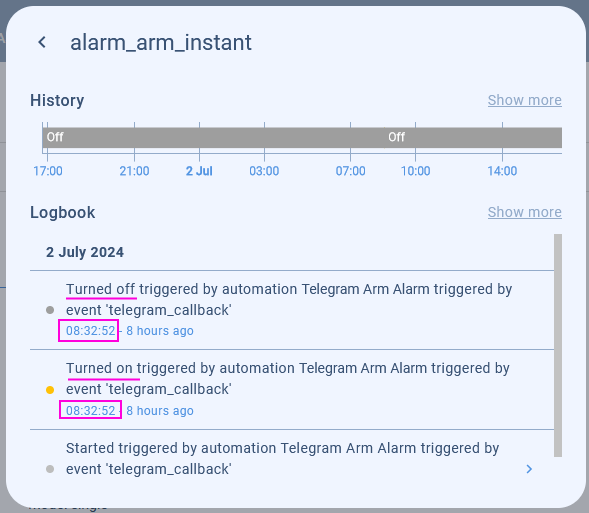

Or view the log book entry in the more info pop-up card.
Compared to one of my scripts that has lots of delays in it that takes 30 seconds to complete:
