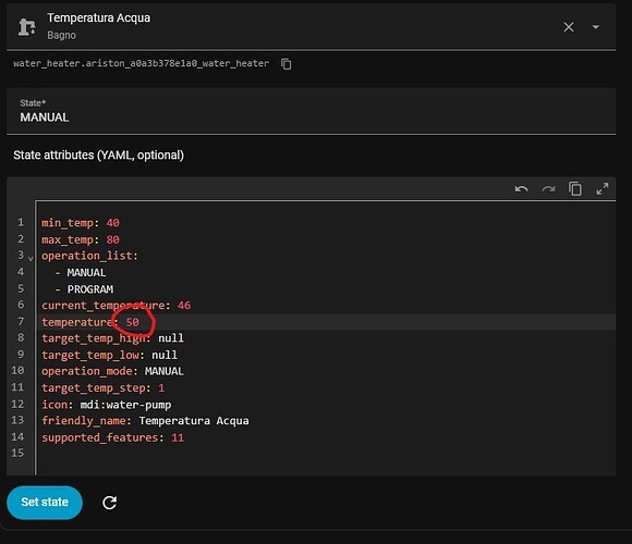

Hi all,
i’ve a similar problem with a temperature sensor.
from an integration i’m able to read all attributes of this kind of sensor:
i’ve created some related template to work with automation but only in reading mode.
I’d like to change “temperature” attribute in an automation, how to do this?
thanks in advance
