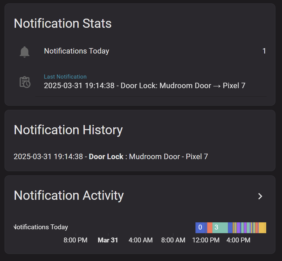

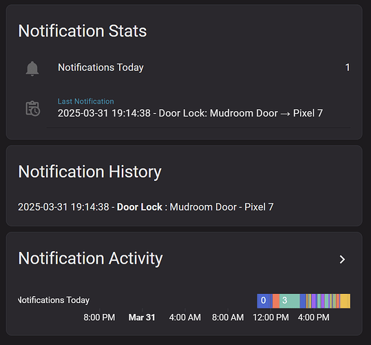

Would be great if there was an ‘Auto-Entities-Notifications’ style Integration where it pulled in every notification (not just Persistent) and we could filter on what we wanted to see in the Dashboard card.
Refining code to provide info for all notifications, not just Persistent. Here’s some of it in a few cards I’m testing. All the code is in a single Automation using only built-in HA functions (nothing custom)
Can you share your code and explain how you did this please? Really nice…
I posted it on the forum a while ago. Checkout my posts
