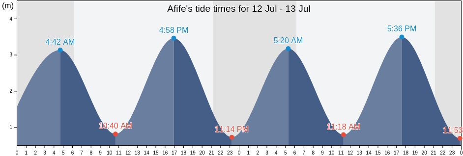

It appears to be working without the date parameter as well:
https://www.tideschart.com/tide-charts/en/Afife-Viana-do-Castelo-Viana-do-Castelo-Portugal-tide-chart-12033000-m.png
Like this it looks like the current date is automatically added.

Ah! You think that the:
-12033000-m
part of the URL is changing each day? That could be…
No, it looks like this part is just the location code.
If you use the same URL, but with for instance the date of yesterday you get the graph from yesterday.
i unable to get other graph date did you test it?

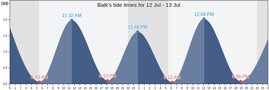

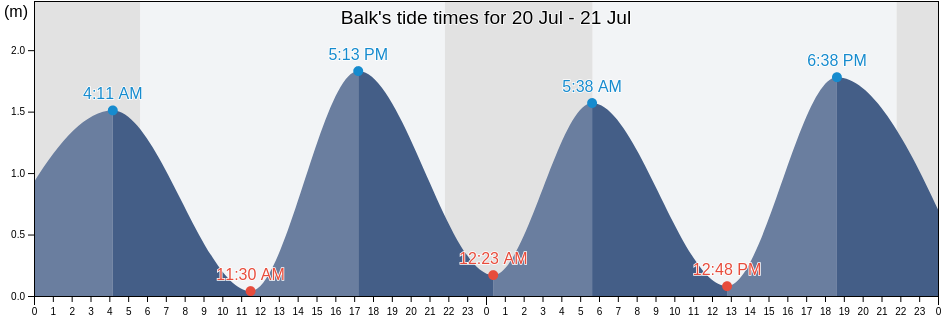

Hmm… Strange. It did work once for me, with these links:
https://www.tideschart.com/tide-charts/en/Balk-De-Fryske-Marren-Friesland-Netherlands-tide-chart-4152145-m.png?date=20250712
https://www.tideschart.com/tide-charts/en/Balk-De-Fryske-Marren-Friesland-Netherlands-tide-chart-4152145-m.png?date=20250710
But indeed it does not work for all other trials that I did.
So not reliable.
By the way, this is a nice website: it shows the tide-charts world-wide.
But one funny thing: I am living in the Netherlands, near the IJsselmeer. This used to be a tidal sea (called the Zuiderzee), but since the Afsluitdijk was finished in 1932 it became a non-tidal lake.
But according to this website we still have a tidal difference of roughly 2 meters… (see the links above).

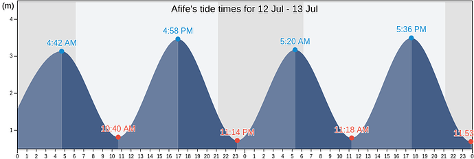

i think this is the best approach so far use this
type: picture-elements
elements: []
image: >-
and wait to see if the image change everyday
lol after click on your link i can see both images from today and from the 10 this is very strange
Wow, it would be fantastic if it would be this easy. I put this on my page for now. Will let you know if it changes tomorrow.

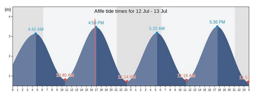

After putting this on my page, I realized there was one big difference with the .png and the live webpage - the current time/red line is no longer there - Original website. So there must be some other code that overlays the tide .png with the current time marker.
The date did change but I’d like to find a solution if I can that includes the current time marker.
Go with the version that adds a dynamic date to the URL.
This will prevent cache issues, where the picture is not updated, because the browser app think it already got the newest one in its cache.
That version doesn’t add the red time bar either. I think I will keep my old iframe and continue to scroll down to the part I want to see until I figure out how to display only the graph section.
try with this option
to see if the image change as i test it and in fact the date change, but only ones
this one will not show the hour line as you a re not using java to that
i will takje a look if i can extract the java information to a custom page
