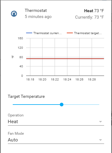

Okay, so I loaded in my thermostat from the Vera controller and this is what it looks like on the front end:
When I click on that card I get:
I can click on the Operation and Fan Mode dropdowns and get the options associated with those but the temperature adjustment is in half-degree increments in HA whereas in Vera and on the actual unit itself, it is in whole degree increments. Trying to adjust it from HA using the slider, it read 73.1. It completely ignored 73.6 and changing it to 74.1 in HA triggered the system on, but when I looked at the actual display on the unit itself it showed a set point of 71 degrees.
So it would seem that there are some issues there with the setpoint temperature. Vera doesn’t treat it this way, it gives me a drop down with whole degree selections. Without taking the controller off the Vera Hub and moving it to the Aeotec ZStick I am not sure if there would be some changes I could make in the OZWCP
