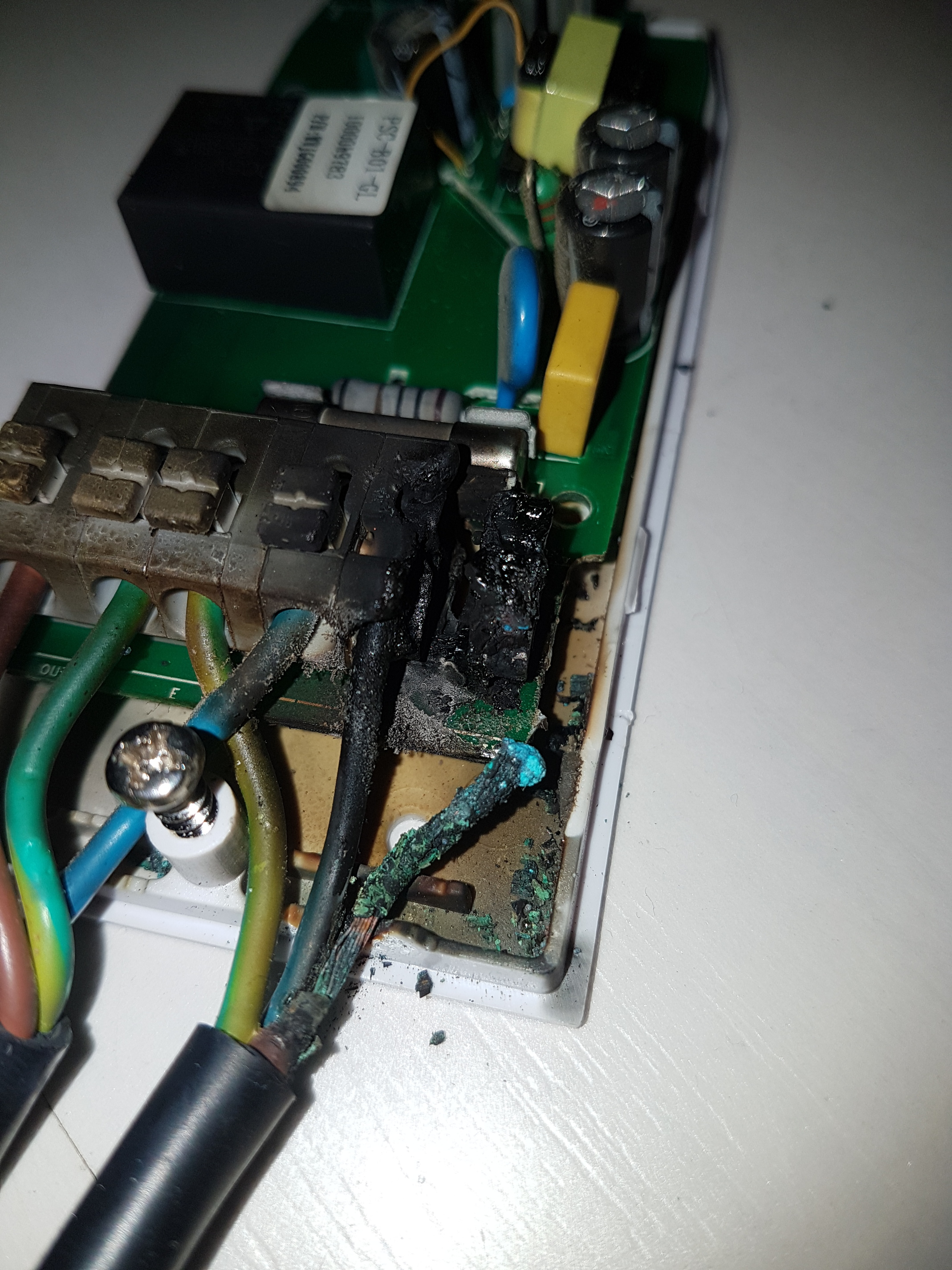

Just recently this happened to a Sonoff POW I used to check how much power my dryer is using during a regular cycle:
It’s rated for 16A on the label. The dryer never went above 11A (I double-checked with another, non-Sonoff device). I do have Sonoffs in other places that don’t handle much electric load. But having experienced this kind of failure makes me think twice about what I use chinese products for, and where instead I go with pricier models which have passed local quality tests.

What does the rest of that sonoff look like? What gauge are those cables? What amperage are the cables rated for?

Would be intrested to know where this POW failed, from this picture (which doesn’t show much) it looks like the input wire fried.

Yeah this was my main concern with using these products. With any power monitoring I am using the xiaomi plug type devices and using sonoff just for lighting circuits. I may however rethink this design now, I’m not using the POW model but that looks like it could happen to any of the models.

After opening the case and having a further look I can confirm, that it indeed seems to be the cable that was the issue. Or at least the connection. The cable is rated for 16A. But as we can see on the new image, the area of the connector is where the most heat was (judged by where the blue cable has the most burning).

Yeah, I usually only use Sonoffs for lower loads as well. Even with increasing quality of those products, a german insurance wouldn’t pay if it caused damage.

For some usecases Sonoffs still are perfectly fine and a cheap solution. Attaching the Pow to the dryer was a test since I’ve read before, that there might be issues with failure. Usually the dryer is attached to a Homematic power meter switch for costs 50€. That switch though is really safe to use. And if it would catch fire, the insurance still would have to pay because it’s a certified product.
That looks like the old sonoff POW the one that had this issue?

Sorry to revive this old thread - I am really wavering between CT clamp and Sonoff POW for monitoring my modern Miele washing machine. Can you tell me (this is the reason for reviving!) what the version number printed on your destroyed POW is, please? This is mine
that’s a 2000W+ appliance, do NOT use a Sonoff pow for that, no matter the version
