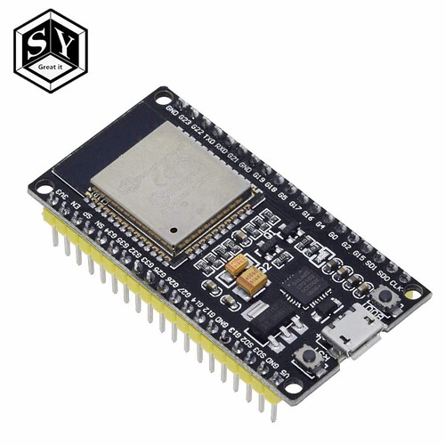

Is there a Difference between c106 yellow capacitors and black ones on ESP32 boards?
So noob question here.
I bought this ESP32 boards from Aliexpress: https://www.aliexpress.com/item/32788387117.html?spm=a2g0o.order_list.order_list_main.23.1efd1802lhJQDR
They came today and I realized that the capacitors there have a different color.
Since my knowledge of the internal components is really basic, I am not sure if I have to start a dispute with the seller, or if this is really not important.
Any advice is appreciated.
No, both are TANTALUM capacitors
If board works, it’s ok. important is number on it: 10 means 10uF (and 16V, as it says). Markings can be different, like 106 also means 10uF.

Thank you for the response! I also asked on Reddit and I got a similar response and now I am more at easy.
BTW there someone commented on another response with:
Is that true? I thought Tantalums are yellow while Poly’s are Black. Also Poly’s don’t have that explosion risk that Tantalums have.
Sadly they do not sell in Germany.
It’s true that tantalum can “explode”. It’s also true that when tantalum goes bad it many times makes a short, thus destroying rest of circuit…
but, tantalums can be yellow and black.

ESP manufacturers use 3rd party electronic components.
I don’t think it is worth the effort to find out who the producer of the capacitors are; the color and shape may differ from manufacturer to manufacturer, but a 10 µF capasitor is a 10 µF capasitor, regardless of who made them. Besides that, they normally are allowed to have a 10% deviation; it is really not important that they actually are 10 µF.
So the color/shape just depends on where the ESP manufacturer bought their components, which depends on availability and price :wink:
Imho nothing to worry about; I have seen capasitors breaking down in several types of equipment, but after 20 tears or more. Most of the times that concerned electrolytic capasitors (the liquid inside tends to dry up), but also tantalus.
In the meanwhile, also the quality/reliability of the capasitors have increase significantly during the last 20 years :thinking:

Has anyone looked at all the pictures in the aliexpress ad in post 1? Not all of the pics show yellow capacitors, so the device isn’t different to what is advertised anyway.
Thank you for this insightful post!
Could it be that we see different photos in each country? I The model “yellow” (with also yellow legs) has those 2 caps in yellow color. And the other one without 5v pin, has just one but also yellow.
Yeah that’s possible. The whole advert is very confusing.
