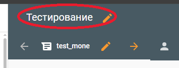

What do you mean by a “dashboard title”?
You mean this?
The only way you can modify this title dynamically is a card-mod-theme.
Also, note that a dashboard title is only shown when the dashboard is in edit mode.
May be you meant a “view title”.
This section I have ment. :wink:
I am not getting. Do you mean a label of this UI control to add a header? Or a text of an an added header?
