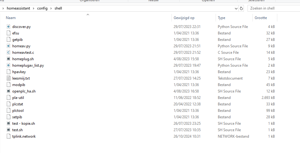

I did not find any either, so I made one myself using openplc tools and a script which parses openplc output and publishes it on the MQTT broker.

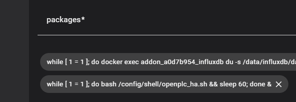

I run a custom script every 60 seconds through the Advanced SSH and Web terminal HA addon: (second line)
under my HA config folder I added a shell map where I placed following openplc_ha.sh script and files:
interface is my HA ethernet network port name (my HA crashed last week and I just noticed on reinstalling from a backup, network name changed, so it could not find it, I run HA on a ESXi host)
p is where my files are located

I downloaded the openplc linux binaries from here: Example for a SLAC Association with the INSYS Powerline GP

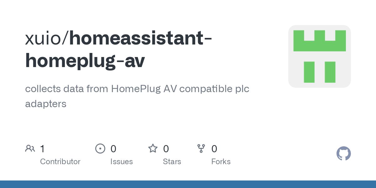

Picking up on this topic: I just built an integration that can do this! I ported pla-utils to python and then integrated it into homeassistant, so that it does not depend on any external dependencies. It’s pretty rudimentary and might not be stable, but you can check it out here:
let me know if you encounter any issues!

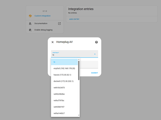

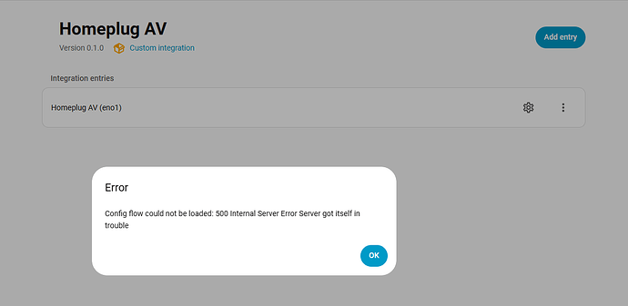

hey I just tried your integration but can’t get it to work.
if I add it, I get following IP ports and I selected enp3s0 (with HA IP 192.168.178.20).
But the integration can’t seem to find any PowerLAN adapters.
I also tried the other LAN adapters, but enp3s0 is the right one. (ESXi).
Maybe it’s because I reflashed my TPLink PowerLAN’s with other more rescent PowerLAN firmware (CHIPSET: QCA7500 firmware: MAC-QCA7500-2.13.0.30-01-20221117-CS) .
Strange because my scripts (see a couple of posts above) do work and return info with PLCstat tools (openPLC).

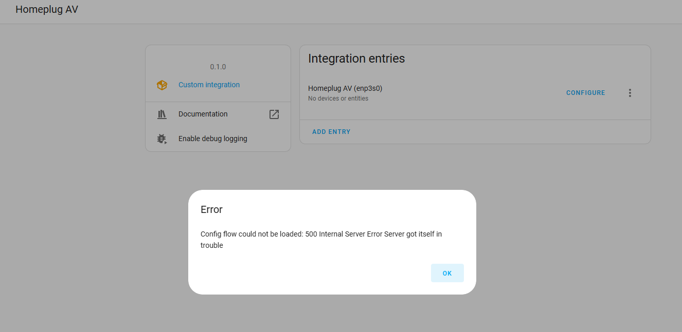

also when i try to “configure” an existing entry I get error :
to debug this further: could you check if your adapters are discovered by pla_util?
My Integration uses the same protocol.
according to this: Powerline Connection Speed Monitoring via pla-util · peanball.net
pla_util is for Broadcom chipset based powerline adapters, while my TPLink Powerline adapters are Qualcomm Atheros chipset based powerline adapters. Mine work with open-plc-utils.
So maybe that’s the problem ?

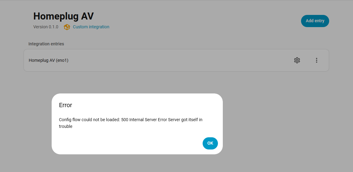

Hi! I wonder if someone could help me out a bit with this. I am using a TP-Link PA9020 kit , which should be supported by pla_util. I have installed the Homeplug AV integration to scan eno1 (actually I have tried every interface available) but I also get the same error as monty above!
I have tried to install and run the pla_utils from within the homeplug_av directories. It runs but does not display any result.
From the HA debug i get:
TypeError: HomeplugAVConfigFlow.async_get_options_flow() missing 1 required positional argument: ‘config_entry’
Can anyone help me get this working?
I should say that I run HA in a docker compose environment!!!
Same here… :frowning:
Home assistant over Proxmox
Worked for me on a Homeassistant Green, but does not see any devices on Docker. Can we provide the IP addresses of the devices in configuration.yaml (like I have to do with Sonos on Docker)?
