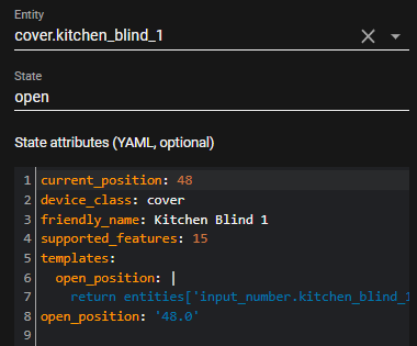

I am trying to fathom how this works but cannot fully understand.
I have covers that I would like to add an attribute open_position: to which would be the value from an input_number helper by the same name i.e. [cover|input_number].kitchen blind_1 for example and trying to dtermine the cleanest way to do this in customize.yaml…

I found 2 other entities I gleaned from somewhere which template their friendly_name: in a strange way so I copied that code and now have
cover.kitchen_blind_1:
  device_class: cover
  templates:
    open_position: >
     return entities['input_number.kitchen_blind_1'].state;
cover.kitchen_blind_2:
  device_class: cover
  templates:
    open_position: >
     return entities['input_number.kitchen_blind_2'].state;
cover.kitchen_blind_3:
  device_class: cover
  templates:
    open_position: >
     return entities['input_number.kitchen_blind_3'].state;
cover.living_room_blind:
  device_class: cover
  templates:
    open_position: >
     return entities['input_number.living_room_blind'].state;
cover.patio_door_blind:
  device_class: cover
  templates:
    open_position: >
     return entities['input_number.patio_door_blind'].state;
cover.bedroom_blind:
  device_class: cover
  templates:
    open_position: >
     return entities['input_number.bedroom_blind'].state;
I would like to return the value as an integer rather than a string with .0 but have not figured out if that is possible or not…

I have the same problem: need a number, not a string…
edit:
try this:
return parseInt(entities['input_number.bedroom_blind'].state);
