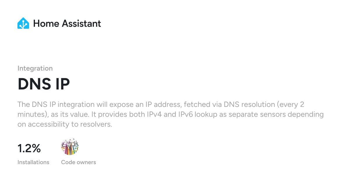

Set up the DNSIP integration with defaults so it reports your currently connected ip.
Then implement an automation like this:

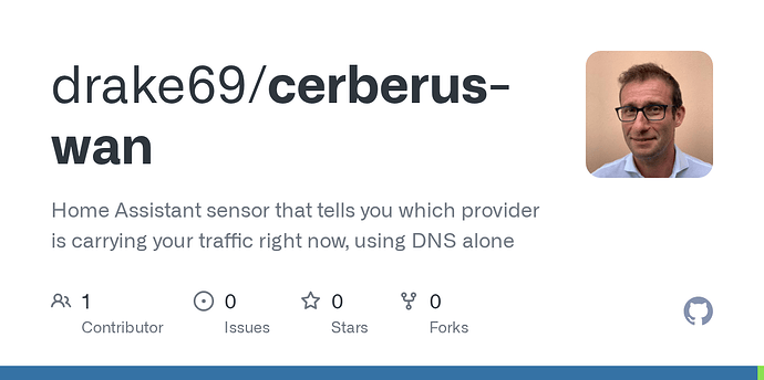

Thanks, all of you. Four different approaches came back, and none of them is
the one I ended up with, so let me close the loop.
@tim.plas you asked to be told if I packaged it. I did:
What it does differently: it never asks the router anything. Every 15 seconds
it asks myip.opendns.com of the OpenDNS resolvers what my public address is,
and when that address is one it has not seen before, it asks the Team Cymru DNS
service which autonomous system announces it. The AS number is then looked up
in a table you write yourself (35612 = Eolo;). The sensor reads your own
provider names, plus Disconnected and Unknown.
