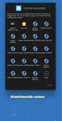

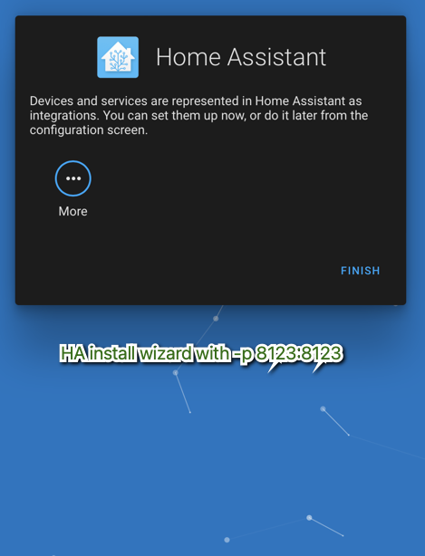

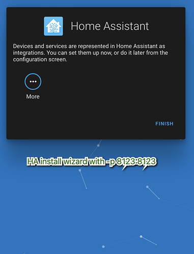

I don’t think this is completely valid, because during the installation of HA, without any add-ons installed, the system behaves diffrently if you are using --net=host or -p 8123, as you can see below.
So obviously something is not communicating properly when using -p 8123.
