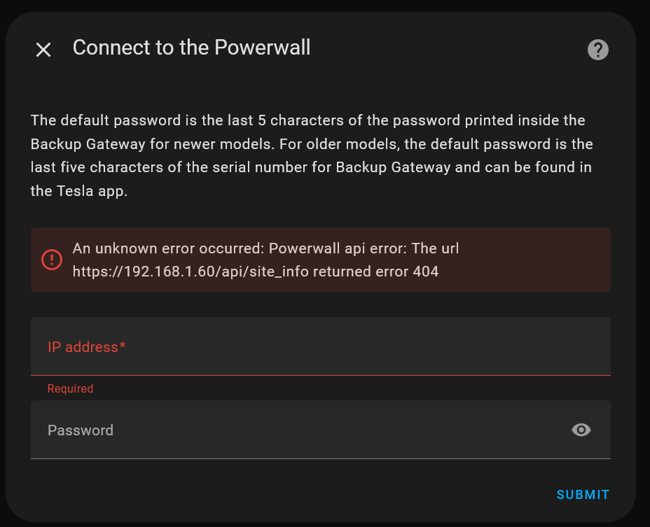

I’m trying to set up Tesla > Tesla Powerwall integration with newly installed Powerwall 3, and hit the following error after entering IP and password:
An unknown error occurred: Powerwall api error: The url https://192.168.1.60/api/site_info returned error 404
Can’t find much online, but apparently it’s an issue with Tesla locking down Powerwal 3 API?
I was really looking forward to getting a bunch of automations set up based off solar production, and it looks like it’s no longer possible.
What are my options if any? Thanks.
