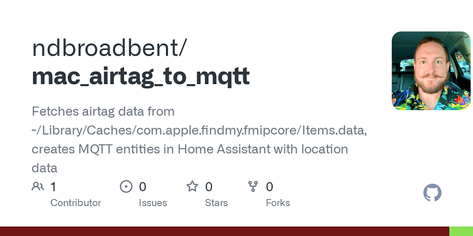

@Mommeke This is awesome! Thanks for the tip about the JSON data at ~/Library/Caches/com.apple.findmy.fmipcore/Items.data.
I wrote a small Ruby script to read the file and create entities in Home Assistant via MQTT discovery:
It’s only running if my Macbook is active, but this is a lot better than nothing! It’s very cool to have all my AirTag location data in Home Assistant.

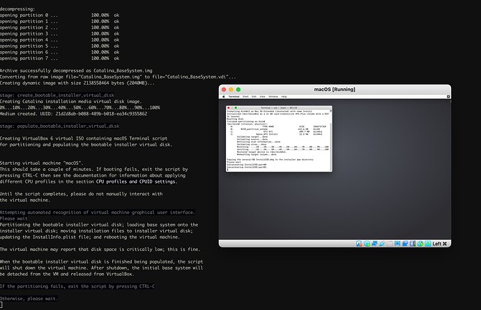

I’ve been looking into this some more, and setting it up on my wife’s Macbook so that we can track her Airtags as well. The only problem is that she doesn’t use her Macbook very often and it is often closed, so I think I might need to run macOS in a VM on my server.
I found Push-button installer of macOS on VirtualBox: GitHub - myspaghetti/macos-virtualbox: Push-button installer of macOS Catalina, Mojave, and High Sierra guests in Virtualbox for Windows, Linux, and macOS
This looks awesome! I need to set these variables to get the VM to work with iCloud and the Find My app:

I’m a bit concerned about the resource usage - this requires a minimum of 22GB disk space per VM, and it’s probably going to use a lot of RAM. Hopefully not too much CPU usage. Fortunately my server has 32GB of RAM so it should be ok. Will update this comment with the results.

This script is so cool! It actually takes screenshots of the VM window and uses OCR to find text in the UI. Then it simulates mouse clicks and typing to automate the whole installation and setup process.
Super impressed so far.
Crashed:
stage: create_target_virtual_disk
Attempting to install macOS Catalina on a disk smaller than 25000MB will fail.
Please assign a larger virtual disk image size. Exiting.
Increasing from 22000 to 25000 and trying again…
Didn’t work unfortunately:
This was macOS Catalina, so either it was too old, or I didn’t set up the fake serial numbers properly.
I’m going to try again with OSX-KVM: GitHub - kholia/OSX-KVM: Run macOS on QEMU/KVM. With OpenCore + Big Sur + Monterey + Ventura support now! Only commercial (paid) support is available now to avoid spammy issues. No Mac system is required.
This one is maintained and has the latest versions of macOS, and it’s much more performant when running with qemu. I also found this detailed page about fixing iMessage and iCloud: Fixing iMessage and other services with OpenCore | OpenCore Post-Install
I think I’m going to leave it there for now, but I think this is the right track.
