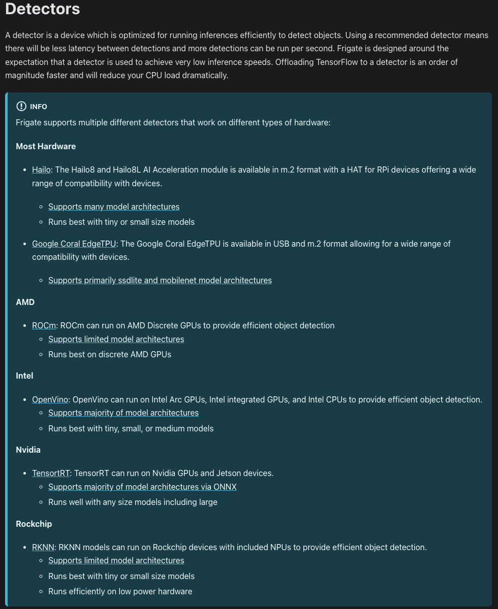

See Recommended hardware | Frigate

Is there a preference of one over the other? I have read the Frigate wiki and doesn’t seem to give an indication. Is there a difference in the smartness of object detection of things? For speed, I can bundle up more and more.

Depends on your priorities (ex: power consumption vs performance) and your current hardware
That comes down to the models that can be run, which the docs explain
