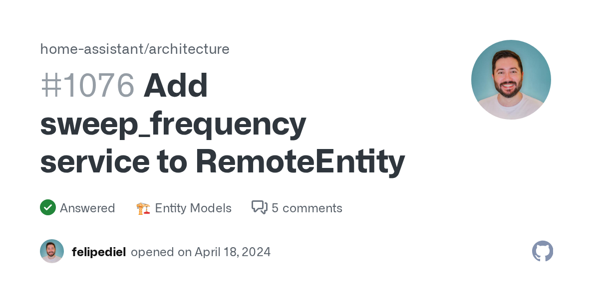

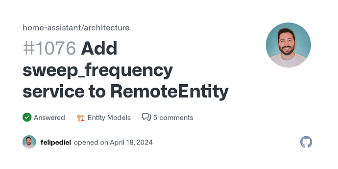

I’ll add a plea here for more Broadlink users to pile onto the architecture discussion that is blocking the HA learn feature from being updated to make learning RF remotes much easier:
