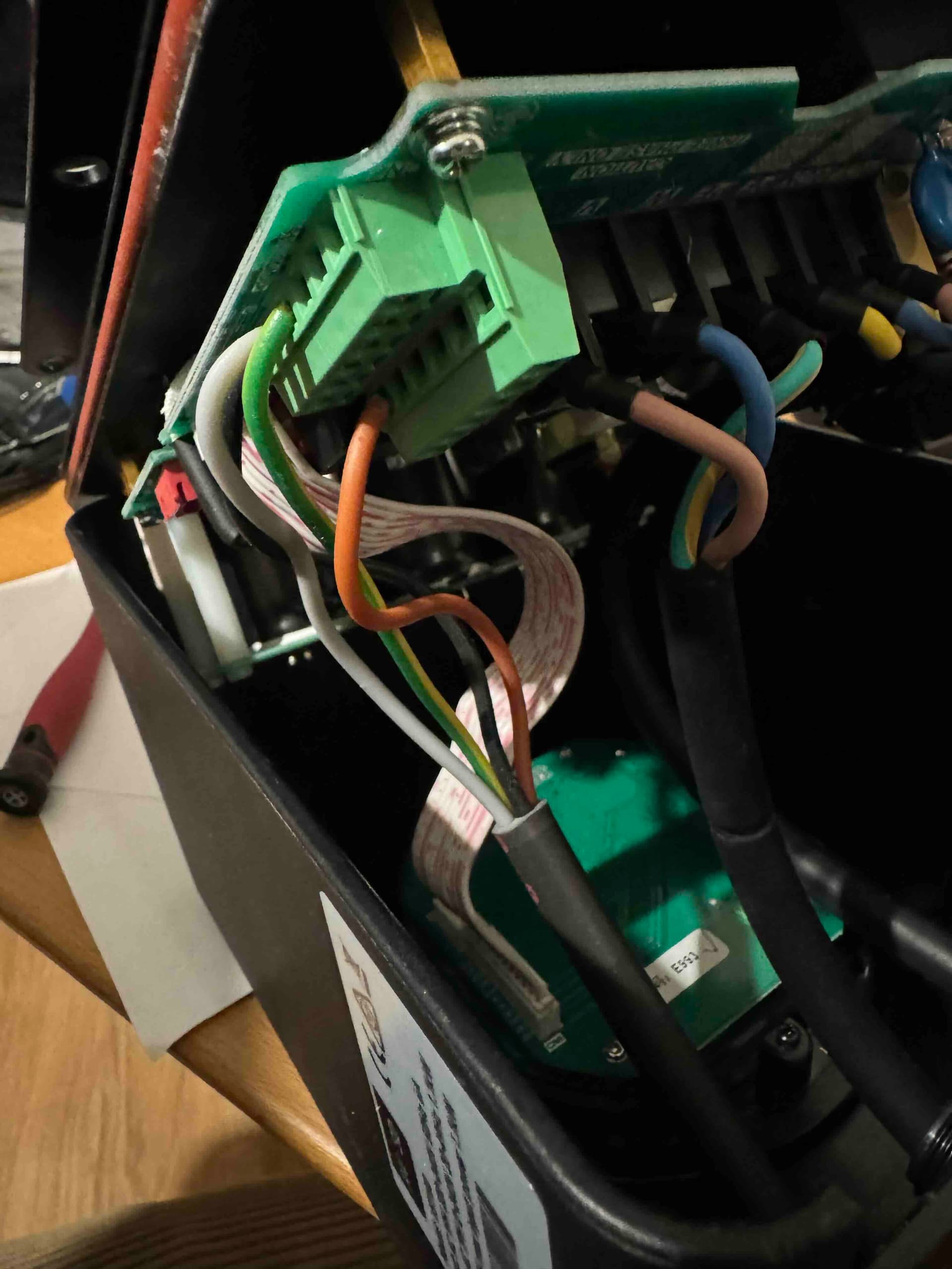

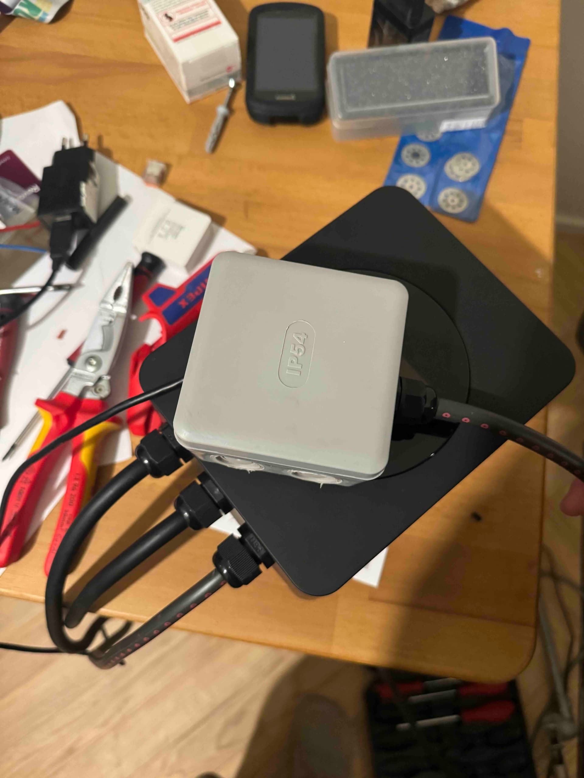

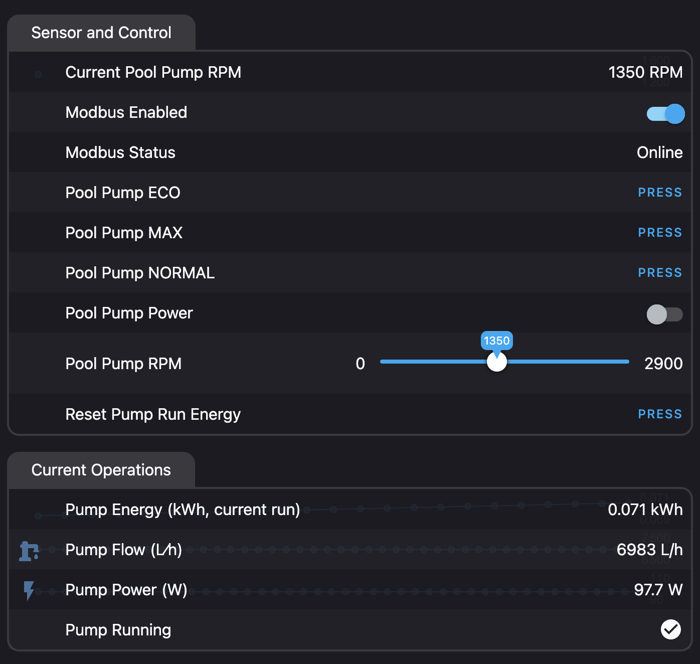

Isaver pool pump speed control MODBUS => Waveshare USB to RS485
Ah gotcha, there is a sensor already added in my code for this.
It’s a binary sensor called Pump On.
Makes sense, thanks! I’ve replaced both the esp32 and modbus matching your components but unfortunately I’m still having an issue with the “running” state. When the pump is off, the RPM is still reporting what it was previously so “Pump running” always reports “Running”
At the start of this log, the pump is actually off. Then I turn the pump on updates the pump RPM correctly to 2900rpm. I then turn the pump off (which does actually turn off the pump), but the reported RPM doesn’t update:
I’m using your code directly except for ota/api/wifi sections. Any idea what could be wrong here?

[21:15:18.835][D][sensor:135]: 'Pump Flow (L/min)': Sending state 166.55171 L/min with 1 decimals of accuracy
[21:15:18.836][D][sensor:135]: 'Pump Power (W)': Sending state 412.85052 W with 1 decimals of accuracy
[21:15:18.887][D][uart_debug:113]: <<< FC
[21:15:19.071][D][uart_debug:113]: >>> AA:C3:07:D1:00:00:0D:4D
[21:15:19.189][D][uart_debug:113]: <<< AA:C3:00:00:00:00:00
[21:15:19.859][D][sensor:135]: 'Pump Flow (L/min)': Sending state 166.55171 L/min with 1 decimals of accuracy
[21:15:19.859][D][sensor:135]: 'Pump Power (W)': Sending state 412.85052 W with 1 decimals of accuracy
[21:15:19.888][D][uart_debug:113]: <<< FC
[21:15:20.064][D][uart_debug:113]: >>> AA:C3:07:D1:00:00:0D:4D
[21:15:20.087][D][sensor:135]: 'Pump Energy (kWh, current run)': Sending state 0.57297 kWh with 3 decimals of accuracy
[21:15:20.178][D][uart_debug:113]: <<< AA:C3:00:00:00:00:00
[21:15:20.582][D][switch:022]: 'Pool Pump Power' Turning ON.
[21:15:20.587][D][number:064]: 'Pool Pump RPM': Setting value
[21:15:20.594][D][number:123]:   New value: 2100.000000
[21:15:20.595][D][uart_debug:113]: <<< FC
[21:15:20.678][D][switch:065]: 'Pool Pump Power': Sending state ON
[21:15:20.721][D][uart_debug:113]: >>> AA:D0:0B:B9:08:34:0C:15
[21:15:20.829][D][sensor:135]: 'Pump Power (W)': Sending state 412.85052 W with 1 decimals of accuracy
[21:15:20.835][D][sensor:135]: 'Pump Flow (L/min)': Sending state 166.55171 L/min with 1 decimals of accuracy
[21:15:21.830][D][sensor:135]: 'Pump Flow (L/min)': Sending state 166.55171 L/min with 1 decimals of accuracy
[21:15:21.837][D][sensor:135]: 'Pump Power (W)': Sending state 412.85052 W with 1 decimals of accuracy
[21:15:21.900][D][uart_debug:113]: <<< AA:D0:0B:B9:00:02:00:FF
[21:15:22.076][D][uart_debug:113]: >>> AA:C3:07:D1:00:00:0D:4D
[21:15:22.111][D][sensor:135]: 'Current Pool Pump RPM': Sending state 2900.00000 RPM with 0 decimals of accuracy
[21:15:22.111][D][number:034]: 'Pool Pump RPM': Sending state 2900.000000
[21:15:22.111][D][text_sensor:097]: 'Modbus Status': Sending state 'Online'
[21:15:22.112][D][sensor:135]: 'Pump Energy (kWh, current run)': Sending state 0.57320 kWh with 3 decimals of accuracy
[21:15:22.212][D][uart_debug:113]: <<< AA:C3:00:00:01:0B:54
[21:15:22.831][D][sensor:135]: 'Pump Power (W)': Sending state 975.99902 W with 1 decimals of accuracy
[21:15:22.838][D][sensor:135]: 'Pump Flow (L/min)': Sending state 230.00000 L/min with 1 decimals of accuracy
[21:15:22.899][D][uart_debug:113]: <<< FF
[21:15:23.078][D][uart_debug:113]: >>> AA:C3:07:D1:00:00:0D:4D
[21:15:23.090][D][text_sensor:097]: 'Modbus Status': Sending state 'Online'
[21:15:23.244][D][uart_debug:113]: <<< AA:C3:00:00:01:0B:54
[21:15:23.851][D][sensor:135]: 'Pump Power (W)': Sending state 975.99902 W with 1 decimals of accuracy
[21:15:23.852][D][sensor:135]: 'Pump Flow (L/min)': Sending state 230.00000 L/min with 1 decimals of accuracy
[21:15:23.892][D][uart_debug:113]: <<< FF
[21:15:24.078][D][uart_debug:113]: >>> AA:C3:07:D1:00:00:0D:4D
[21:15:24.092][D][text_sensor:097]: 'Modbus Status': Sending state 'Online'
[21:15:24.108][D][sensor:135]: 'Pump Energy (kWh, current run)': Sending state 0.57374 kWh with 3 decimals of accuracy
[21:15:24.199][D][uart_debug:113]: <<< AA:C3:00:00:01:0B:54
[21:15:24.838][D][sensor:135]: 'Pump Flow (L/min)': Sending state 230.00000 L/min with 1 decimals of accuracy
[21:15:24.844][D][sensor:135]: 'Pump Power (W)': Sending state 975.99902 W with 1 decimals of accuracy
[21:15:24.894][D][uart_debug:113]: <<< FF
[21:15:25.080][D][uart_debug:113]: >>> AA:C3:07:D1:00:00:0D:4D
[21:15:25.092][D][text_sensor:097]: 'Modbus Status': Sending state 'Online'
[21:15:25.199][D][uart_debug:113]: <<< AA:C3:00:00:01:0B:54
[21:15:25.842][D][sensor:135]: 'Pump Flow (L/min)': Sending state 230.00000 L/min with 1 decimals of accuracy
[21:15:25.849][D][sensor:135]: 'Pump Power (W)': Sending state 975.99902 W with 1 decimals of accuracy
[21:15:25.900][D][uart_debug:113]: <<< FF
[21:15:26.074][D][uart_debug:113]: >>> AA:C3:07:D1:00:00:0D:4D
[21:15:26.098][D][text_sensor:097]: 'Modbus Status': Sending state 'Online'
[21:15:26.116][D][sensor:135]: 'Pump Energy (kWh, current run)': Sending state 0.57429 kWh with 3 decimals of accuracy
[21:15:26.206][D][uart_debug:113]: <<< AA:C3:00:00:01:0B:54
[21:15:26.843][D][sensor:135]: 'Pump Power (W)': Sending state 975.99902 W with 1 decimals of accuracy
[21:15:26.846][D][sensor:135]: 'Pump Flow (L/min)': Sending state 230.00000 L/min with 1 decimals of accuracy
[21:15:26.933][D][uart_debug:113]: <<< FF
[21:15:27.076][D][uart_debug:113]: >>> AA:C3:07:D1:00:00:0D:4D
[21:15:27.129][D][text_sensor:097]: 'Modbus Status': Sending state 'Online'
[21:15:27.199][D][uart_debug:113]: <<< AA:C3:00:00:01:0B:54
[21:15:27.846][D][sensor:135]: 'Pump Power (W)': Sending state 975.99902 W with 1 decimals of accuracy
[21:15:27.846][D][sensor:135]: 'Pump Flow (L/min)': Sending state 230.00000 L/min with 1 decimals of accuracy
[21:15:27.897][D][uart_debug:113]: <<< FF
[21:15:28.078][D][uart_debug:113]: >>> AA:C3:07:D1:00:00:0D:4D
[21:15:28.091][D][text_sensor:097]: 'Modbus Status': Sending state 'Online'
[21:15:28.120][D][sensor:135]: 'Pump Energy (kWh, current run)': Sending state 0.57483 kWh with 3 decimals of accuracy
[21:15:28.200][D][uart_debug:113]: <<< AA:C3:00:00:01:0B:54
[21:15:28.871][D][sensor:135]: 'Pump Power (W)': Sending state 975.99902 W with 1 decimals of accuracy
[21:15:28.871][D][sensor:135]: 'Pump Flow (L/min)': Sending state 230.00000 L/min with 1 decimals of accuracy
[21:15:28.898][D][uart_debug:113]: <<< FF
[21:15:29.085][D][uart_debug:113]: >>> AA:C3:07:D1:00:00:0D:4D
[21:15:29.097][D][text_sensor:097]: 'Modbus Status': Sending state 'Online'
[21:15:29.207][D][uart_debug:113]: <<< AA:C3:00:00:01:0B:54
[21:15:29.842][D][sensor:135]: 'Pump Flow (L/min)': Sending state 230.00000 L/min with 1 decimals of accuracy
[21:15:29.848][D][sensor:135]: 'Pump Power (W)': Sending state 975.99902 W with 1 decimals of accuracy
[21:15:29.900][D][uart_debug:113]: <<< FF
[21:15:30.099][D][uart_debug:113]: >>> AA:C3:07:D1:00:00:0D:4D
[21:15:30.099][D][text_sensor:097]: 'Modbus Status': Sending state 'Online'
[21:15:30.118][D][sensor:135]: 'Pump Energy (kWh, current run)': Sending state 0.57537 kWh with 3 decimals of accuracy
[21:15:30.219][D][uart_debug:113]: <<< AA:C3:00:00:01:0B:54
[21:15:30.843][D][sensor:135]: 'Pump Power (W)': Sending state 975.99902 W with 1 decimals of accuracy
[21:15:30.849][D][sensor:135]: 'Pump Flow (L/min)': Sending state 230.00000 L/min with 1 decimals of accuracy
[21:15:30.911][D][uart_debug:113]: <<< FF
[21:15:31.119][D][uart_debug:113]: >>> AA:C3:07:D1:00:00:0D:4D
[21:15:31.119][D][text_sensor:097]: 'Modbus Status': Sending state 'Online'
[21:15:31.224][D][uart_debug:113]: <<< AA:C3:00:00:01:0B:54
[21:15:31.844][D][sensor:135]: 'Pump Power (W)': Sending state 975.99902 W with 1 decimals of accuracy
[21:15:31.850][D][sensor:135]: 'Pump Flow (L/min)': Sending state 230.00000 L/min with 1 decimals of accuracy
[21:15:31.902][D][uart_debug:113]: <<< FF
[21:15:32.082][D][uart_debug:113]: >>> AA:C3:07:D1:00:00:0D:4D
[21:15:32.095][D][text_sensor:097]: 'Modbus Status': Sending state 'Online'
[21:15:32.146][D][sensor:135]: 'Pump Energy (kWh, current run)': Sending state 0.57592 kWh with 3 decimals of accuracy
[21:15:32.216][D][uart_debug:113]: <<< AA:C3:00:00:01:0B:54
[21:15:32.863][D][sensor:135]: 'Pump Power (W)': Sending state 975.99902 W with 1 decimals of accuracy
[21:15:32.864][D][sensor:135]: 'Pump Flow (L/min)': Sending state 230.00000 L/min with 1 decimals of accuracy
[21:15:32.913][D][uart_debug:113]: <<< FF
[21:15:33.086][D][uart_debug:113]: >>> AA:C3:07:D1:00:00:0D:4D
[21:15:33.097][D][text_sensor:097]: 'Modbus Status': Sending state 'Online'
[21:15:33.205][D][uart_debug:113]: <<< AA:C3:00:00:01:0B:54
[21:15:33.852][D][sensor:135]: 'Pump Flow (L/min)': Sending state 230.00000 L/min with 1 decimals of accuracy
[21:15:33.887][D][sensor:135]: 'Pump Power (W)': Sending state 975.99902 W with 1 decimals of accuracy
[21:15:33.905][D][uart_debug:113]: <<< FF
[21:15:34.091][D][uart_debug:113]: >>> AA:C3:07:D1:00:00:0D:4D
[21:15:34.098][D][text_sensor:097]: 'Modbus Status': Sending state 'Online'
[21:15:34.119][D][sensor:135]: 'Pump Energy (kWh, current run)': Sending state 0.57646 kWh with 3 decimals of accuracy
[21:15:34.219][D][uart_debug:113]: <<< AA:C3:00:00:01:0B:54
[21:15:34.855][D][sensor:135]: 'Pump Power (W)': Sending state 975.99902 W with 1 decimals of accuracy
[21:15:34.861][D][sensor:135]: 'Pump Flow (L/min)': Sending state 230.00000 L/min with 1 decimals of accuracy
[21:15:34.910][D][uart_debug:113]: <<< FF
[21:15:35.121][D][uart_debug:113]: >>> AA:C3:07:D1:00:00:0D:4D
[21:15:35.122][D][text_sensor:097]: 'Modbus Status': Sending state 'Online'
[21:15:35.217][D][uart_debug:113]: <<< AA:C3:00:00:01:0B:54
[21:15:35.862][D][sensor:135]: 'Pump Flow (L/min)': Sending state 230.00000 L/min with 1 decimals of accuracy
[21:15:35.871][D][sensor:135]: 'Pump Power (W)': Sending state 975.99902 W with 1 decimals of accuracy
[21:15:35.935][D][uart_debug:113]: <<< FF
[21:15:36.106][D][uart_debug:113]: >>> AA:C3:07:D1:00:00:0D:4D
[21:15:36.139][D][text_sensor:097]: 'Modbus Status': Sending state 'Online'
[21:15:36.142][D][sensor:135]: 'Pump Energy (kWh, current run)': Sending state 0.57701 kWh with 3 decimals of accuracy
[21:15:36.242][D][uart_debug:113]: <<< AA:C3:00:00:01:0B:54
[21:15:36.870][D][sensor:135]: 'Pump Flow (L/min)': Sending state 230.00000 L/min with 1 decimals of accuracy
[21:15:36.876][D][sensor:135]: 'Pump Power (W)': Sending state 975.99902 W with 1 decimals of accuracy
[21:15:36.926][D][uart_debug:113]: <<< FF
[21:15:37.113][D][uart_debug:113]: >>> AA:C3:07:D1:00:00:0D:4D
[21:15:37.128][D][text_sensor:097]: 'Modbus Status': Sending state 'Online'
[21:15:37.234][D][uart_debug:113]: <<< AA:C3:00:00:01:0B:54
[21:15:37.888][D][sensor:135]: 'Pump Power (W)': Sending state 975.99902 W with 1 decimals of accuracy
[21:15:37.889][D][sensor:135]: 'Pump Flow (L/min)': Sending state 230.00000 L/min with 1 decimals of accuracy
[21:15:37.927][D][uart_debug:113]: <<< FF
[21:15:38.113][D][uart_debug:113]: >>> AA:C3:07:D1:00:00:0D:4D
[21:15:38.124][D][text_sensor:097]: 'Modbus Status': Sending state 'Online'
[21:15:38.130][D][sensor:135]: 'Pump Energy (kWh, current run)': Sending state 0.57755 kWh with 3 decimals of accuracy
[21:15:38.226][D][uart_debug:113]: <<< AA:C3:00:00:01:0B:54
[21:15:38.904][D][sensor:135]: 'Pump Flow (L/min)': Sending state 230.00000 L/min with 1 decimals of accuracy
[21:15:38.904][D][sensor:135]: 'Pump Power (W)': Sending state 975.99902 W with 1 decimals of accuracy
[21:15:38.932][D][uart_debug:113]: <<< FF
[21:15:39.112][D][uart_debug:113]: >>> AA:C3:07:D1:00:00:0D:4D
[21:15:39.125][D][text_sensor:097]: 'Modbus Status': Sending state 'Online'
[21:15:39.234][D][uart_debug:113]: <<< AA:C3:00:00:01:0B:54
[21:15:39.628][D][switch:026]: 'Pool Pump Power' Turning OFF.
[21:15:39.630][D][number:064]: 'Pool Pump RPM': Setting value
[21:15:39.634][D][number:123]:   New value: 0.000000
[21:15:39.642][D][uart_debug:113]: <<< FF
[21:15:39.723][D][switch:065]: 'Pool Pump Power': Sending state OFF
[21:15:39.767][D][uart_debug:113]: >>> AA:D0:0B:B9:00:01:CB:C2
[21:15:39.878][D][sensor:135]: 'Pump Flow (L/min)': Sending state 230.00000 L/min with 1 decimals of accuracy
[21:15:39.928][D][sensor:135]: 'Pump Power (W)': Sending state 975.99902 W with 1 decimals of accuracy
[21:15:40.140][D][sensor:135]: 'Pump Energy (kWh, current run)': Sending state 0.57810 kWh with 3 decimals of accuracy
[21:15:40.881][D][sensor:135]: 'Pump Power (W)': Sending state 975.99902 W with 1 decimals of accuracy
[21:15:40.888][D][sensor:135]: 'Pump Flow (L/min)': Sending state 230.00000 L/min with 1 decimals of accuracy
[21:15:40.952][D][uart_debug:113]: <<< AA:D0:0B:B9:00:02:00:FF
[21:15:41.117][D][uart_debug:113]: >>> AA:C3:07:D1:00:00:0D:4D
[21:15:41.262][D][uart_debug:113]: <<< AA:C3:00:00:00:00:00
[21:15:41.884][D][sensor:135]: 'Pump Power (W)': Sending state 975.99902 W with 1 decimals of accuracy
[21:15:41.895][D][sensor:135]: 'Pump Flow (L/min)': Sending state 230.00000 L/min with 1 decimals of accuracy
[21:15:41.945][D][uart_debug:113]: <<< FC
[21:15:42.129][D][uart_debug:113]: >>> AA:C3:07:D1:00:00:0D:4D
[21:15:42.145][D][sensor:135]: 'Uptime (s)': Sending state 4990.39600 s with 0 decimals of accuracy
[21:15:42.145][D][text_sensor:097]: 'Uptime (friendly)': Sending state '1 h 23 m 10 s'
[21:15:42.182][D][sensor:135]: 'Pump Energy (kWh, current run)': Sending state 0.57864 kWh with 3 decimals of accuracy
[21:15:42.283][D][uart_debug:113]: <<< AA:C3:00:00:00:00:00
[21:15:42.899][D][sensor:135]: 'Pump Flow (L/min)': Sending state 230.00000 L/min with 1 decimals of accuracy
[21:15:42.899][D][sensor:135]: 'Pump Power (W)': Sending state 975.99902 W with 1 decimals of accuracy
[21:15:42.942][D][uart_debug:113]: <<< FC
[21:15:43.127][D][uart_debug:113]: >>> AA:C3:07:D1:00:00:0D:4D
[21:15:43.138][D][sensor:135]: 'WiFi Signal (%)': Sending state 10.00000 % with 1 decimals of accuracy
[21:15:43.239][D][uart_debug:113]: <<< AA:C3:00:00:00:00:00
[21:15:43.894][D][sensor:135]: 'Pump Flow (L/min)': Sending state 230.00000 L/min with 1 decimals of accuracy
[21:15:43.921][D][sensor:135]: 'Pump Power (W)': Sending state 975.99902 W with 1 decimals of accuracy
[21:15:43.947][D][uart_debug:113]: <<< FE
[21:15:44.136][D][uart_debug:113]: >>> AA:C3:07:D1:00:00:0D:4D
[21:15:44.152][D][sensor:135]: 'ESP Internal Temperature': Sending state 38.90000 °C with 1 decimals of accuracy
[21:15:44.157][D][sensor:135]: 'Pump Energy (kWh, current run)': Sending state 0.57918 kWh with 3 decimals of accuracy
[21:15:44.257][D][uart_debug:113]: <<< AA:C3:00:00:00:00:00
[21:15:44.893][D][sensor:135]: 'Pump Power (W)': Sending state 975.99902 W with 1 decimals of accuracy
[21:15:44.899][D][sensor:135]: 'Pump Flow (L/min)': Sending state 230.00000 L/min with 1 decimals of accuracy
[21:15:44.948][D][uart_debug:113]: <<< FE
[21:15:45.145][D][uart_debug:113]: >>> AA:C3:07:D1:00:00:0D:4D
[21:15:45.151][D][sensor:135]: 'WiFi Signal (dB)': Sending state -78.00000 dBm with 0 decimals of accuracy
[21:15:45.255][D][uart_debug:113]: <<< AA:C3:00:00:00:00:00
[21:15:45.893][D][sensor:135]: 'Pump Flow (L/min)': Sending state 230.00000 L/min with 1 decimals of accuracy
[21:15:45.900][D][sensor:135]: 'Pump Power (W)': Sending state 975.99902 W with 1 decimals of accuracy
[21:15:45.972][D][uart_debug:113]: <<< FE
[21:15:46.136][D][uart_debug:113]: >>> AA:C3:07:D1:00:00:0D:4D
[21:15:46.175][D][sensor:135]: 'Pump Energy (kWh, current run)': Sending state 0.57973 kWh with 3 decimals of accuracy
[21:15:46.278][D][uart_debug:113]: <<< AA:C3:00:00:00:00:00
[21:15:46.896][D][sensor:135]: 'Pump Power (W)': Sending state 975.99902 W with 1 decimals of accuracy
[21:15:46.902][D][sensor:135]: 'Pump Flow (L/min)': Sending state 230.00000 L/min with 1 decimals of accuracy
[21:15:46.954][D][uart_debug:113]: <<< FE
[21:15:47.134][D][uart_debug:113]: >>> AA:C3:07:D1:00:00:0D:4D
[21:15:47.251][D][uart_debug:113]: <<< AA:C3:00:00:00:00:00
[21:15:47.916][D][sensor:135]: 'Pump Power (W)': Sending state 975.99902 W with 1 decimals of accuracy
[21:15:47.917][D][sensor:135]: 'Pump Flow (L/min)': Sending state 230.00000 L/min with 1 decimals of accuracy
[21:15:47.954][D][uart_debug:113]: <<< FC
[21:15:48.143][D][uart_debug:113]: >>> AA:C3:07:D1:00:00:0D:4D
[21:15:48.171][D][sensor:135]: 'Pump Energy (kWh, current run)': Sending state 0.58027 kWh with 3 decimals of accuracy
[21:15:48.254][D][uart_debug:113]: <<< AA:C3:00:00:00:00:00
[21:15:48.896][D][sensor:135]: 'Pump Flow (L/min)': Sending state 230.00000 L/min with 1 decimals of accuracy
[21:15:48.906][D][sensor:135]: 'Pump Power (W)': Sending state 975.99902 W with 1 decimals of accuracy
[21:15:48.953][D][uart_debug:113]: <<< FC
[21:15:49.145][D][uart_debug:113]: >>> AA:C3:07:D1:00:00:0D:4D
[21:15:49.254][D][uart_debug:113]: <<< AA:C3:00:00:00:00:00
[21:15:49.905][D][sensor:135]: 'Pump Flow (L/min)': Sending state 230.00000 L/min with 1 decimals of accuracy
[21:15:49.912][D][sensor:135]: 'Pump Power (W)': Sending state 975.99902 W with 1 decimals of accuracy
[21:15:49.963][D][uart_debug:113]: <<< FE
[21:15:50.168][D][uart_debug:113]: >>> AA:C3:07:D1:00:00:0D:4D
[21:15:50.170][D][sensor:135]: 'Pump Energy (kWh, current run)': Sending state 0.58081 kWh with 3 decimals of accuracy
[21:15:50.273][D][uart_debug:113]: <<< AA:C3:00:00:00:00:00
[21:15:50.905][D][sensor:135]: 'Pump Power (W)': Sending state 975.99902 W with 1 decimals of accuracy
[21:15:50.911][D][sensor:135]: 'Pump Flow (L/min)': Sending state 230.00000 L/min with 1 decimals of accuracy
[21:15:50.990][D][uart_debug:113]: <<< FC
[21:15:51.151][D][uart_debug:113]: >>> AA:C3:07:D1:00:00:0D:4D
[21:15:51.292][D][uart_debug:113]: <<< AA:C3:00:00:00:00:00
[21:15:51.911][D][sensor:135]: 'Pump Power (W)': Sending state 975.99902 W with 1 decimals of accuracy

Can you please try to the update I pushed to Github? It treats the states a little different and accounts for errors etc.
Thanks so much, I’ve only tested a few on/off cycles but it seems to be working perfectly now!
Thanks last update works great
My version of how to externalize the esp32 outside the isaver was to replace the contact sec (2 cables) with a thickness equivalent wire but with 4 cables (4G1.5mm) to avoid adding a new hole to the isaver. I then used a larger external wire box to host the esp32 / 485 set up and gave it enough wire length to place it somewhere with better wireless coverage.
I was hoping to have it all inside the isaver but that meant adding a 5v transformer inside and I was a little skeptical with how hot that can get during summer.
