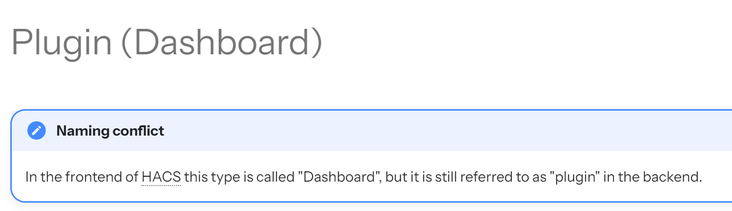

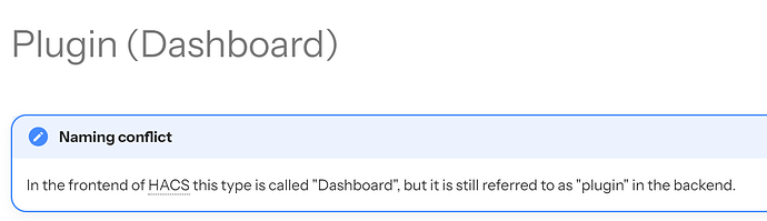

the HACS docs say the term ‘plugins’ (used only in the backend, but depreciated) is now called ‘dashboard’ … they have not updated all the doc pages.
This is from further up in your other link to hacs. Doesn’t look deprecated & explicitly says that dashboards are plugins.
./plugin for plugins (custom cards, dashboards, etc.
maybe not depreciated technically but looks like they are changing the terminology, or not being consistent, which can make things confusing vs using a single same word; not 2 different words to mean the same thing – depending on the location. no biggie
