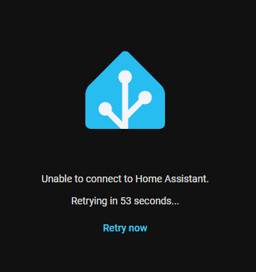

I posted under the same title here a couple of days ago but I think the thread is too old for anyone to seem so I am posting as a new topic but a follow up also.
Currently, I am getting the below when trying to access my HA with my sub domain i.e ha.example.com
While everything is still running perfectly as I am used to, only Home Assistant is not when I try to access it through my PC’s web browser, unless I access it via http://<ip-address>:8123. When I try with my sub domain I get:
And it ends with 400: Bad Request

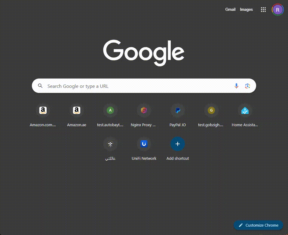

RASBR
(Rami)
April 26, 2026, 8:26pm
17
Unfortunately I didn’t have the time to work around this, I had my bookmark of HA to the IPV4 address:8123 and forgot all about it.
