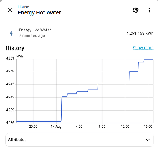

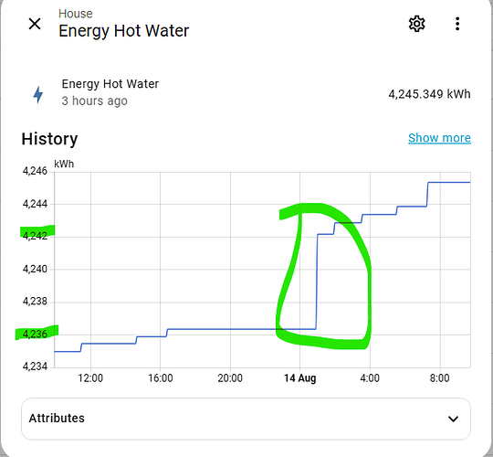

But the energy for it always has this large jump at 1AM - but the thing only is a 1.8KW water heater so the max it can use between 0000-0100 is 1800kw. as being seen the the sensor readings itself.
This seems to happen every morning if the hot water is active over the midnight period.
This throws off the hot water calculations I have on the meter reading for daily hot water, weekly hot water, monthly hot water and yearly hot water that all use the Energy Hot Water as their source. And then the costs for each are calculated on that - so they are also off. Seems to be adding 7+ KW to start each day the hot water is on over the midnight timeslot…

Its not what we use in a day - it seems to start about the 7 for some reason.
The sensor is correct - you can see the usage in the sensor screenshot.
You can see the energy jumps up within an hour of the first day.

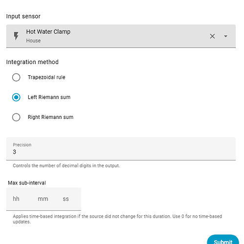

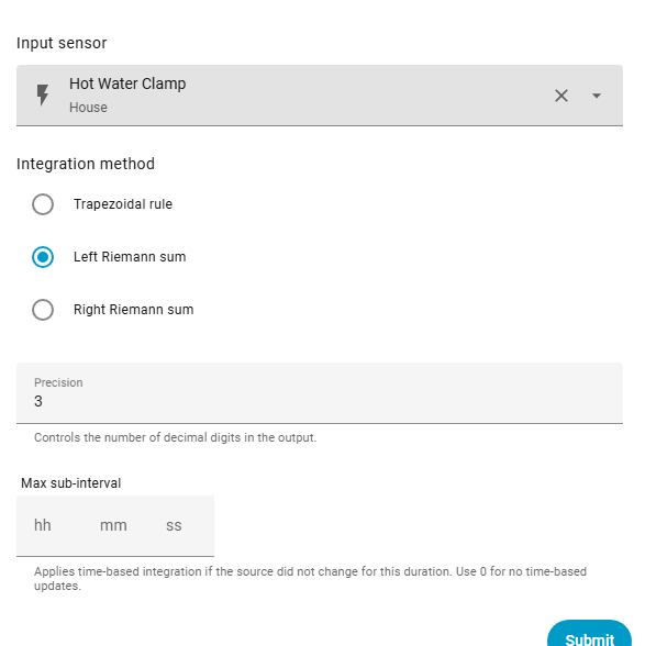

The data is collected as there is a left Riemann helper on the hot water clamp - that creats the energy. I believe this is normal. Then there are multiple meter readers for Daily, weekly, monthly, yearly that all use the same energy sensor.
This is all normal and in use for other things I have - like peak power use and offpeak power use. Its ONLY the hot water that has this strange jump.
Please show your config for the energy sensor as its defined using the power clamp. Are you using a stats sensor or a utility meter?

Here is the energy sensor -
Here is the utility meter for Daily Hote Water -

The issue is the sensor, and the energy do not seem to go hand in hand - Here is today so far for example -

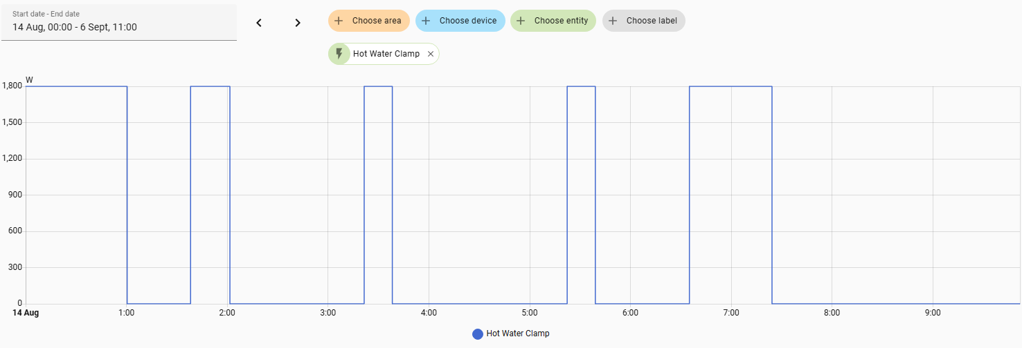

More info - I checked the start and end times for the hot water clamp sensor (screenshot above that you cant click on, but I did) and have this -
14/08 -
0000-0055 - 1800kw - 55mins
0135-0200 - 1800kw - 25mins
0315-0340 - 1800kw - 25mins
0520-0535 - 1800kw - 15mins
0630-0720 - 1800kw - 50mins
1110-1245 - 1800kw - 85mins
1305-1415 - 1800kw - 70mins
1500-1525 - 1800kw - 25mins
1645-1655 - 1800kw - 10mins
total minutes operational - 360mins - 6 hours
total KW used - 6 x 1800 = 10.8KW
Yet the daily HW utility meter says 14.81KW for today.
The Energy hot water goes from 4236 - 4250 - same 14KW as above.

The energy dashboard for NOW is showing Energy Hot Water as 8.7KW.
That does not add up to the totals I did before from the actual sensor… But it it closer that the utility meter’s for Daily hot water are reporting.
There must be an issue with the utility meter here (I dont understand this as they are also pointing to the same Energy Hot Water).

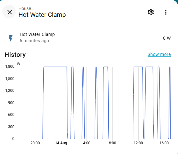

Your HotWater clamp sensor monitors the power.
You use Riemann sum to sum the area under the power curve to give you energy.
You are, correctly, using the ‘Left Rule’. This is the only one that works for step-function changes like a power switch that turns on and off.
HA only records a sensor entity state change every time the value changes. At each change (update) point, HA has the last value (left) and the new value (right).
When your Hot Water goes on, the power state changes from 0 to 1800 Watts. The Riemann sum integration calculates the energy since the last state change, which is 0 (the left value at the last ‘off’) x the period (of being ‘off’).
When your Hot Water goes off, the power state changes from 1800 to 0 Watts. The Riemann sum integration calculates the energy since the last state change, which is 1800 (the left value) x the period (of being ‘on’).
The Hot Water energy sensor will therefore only update the energy used when the power goes off. At 01:00 the power goes off. The power last went on at 21:00, so the time period of the ‘power rectangle’ is 1.8 kW x 4 hours = 7.2 kWh.
This is exactly what the Reimann sum integration should do and that is correct.
The energy sensor will jump by 7+ kWh at 01:00.

Since HA is economical, it only captures and records state changes. Which are then used by the Reimann integration. Which is then used by the Utility meter.
What you really want is for the Reimann sensor to update just before midnight with the energy used, so that the daily utility meter will show the ‘correct’ full daily used energy. This requires HA to record the power state change at midnight, in this case from 1800 down to 0 (which then triggers the update of the energy sensor).
If you held the power sensor value at zero over midnight, it should all work as you want. This can be done by either turning the HotWater system off at 23:59 (and back on again at 00:01 if required) or by setting up a virtual power sensor that does the same for you, without actually turning the hot water off.
Say you had a HWPower sensor, that used the power sensor you already have, but forced or set the state value to 0 for one minute before midnight. This is not something I have tried, but I think could be done with a template sensor that matches the power sensor value, except for one minute to midnight when it returns 0. ‘Virtual’ power goes to 0, energy sensor updates, utility meter records the actual day use. Simple.
