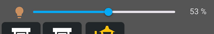

With some HTML styles I had this result. When I click on the lamp itself I get all the lamp settings
type: horizontal-stack
cards:
  - type: entities
    entities:
      - type: custom:multiple-entity-row
        entity: light.tasmota
        show_state: true
        toggle: false
    show_header_toggle: false
    state_color: true
    card_mod:
      style: |
        ha-card {
          height: 25px;
          width: 200px;
          background-color: transparent;
          border-top: 1px;
          border-bottom: 1px ;
          border-left: 1px;
          border-right: 1px;
          border-radius: 1px;
          box-shadow: none;
          left: "-14%";
          font-size: 0px;
          justify-self: left;
          padding left: 10px;
          margin: -20px -10px 0px -10px
cards:
  - type: entities
    entities:
      - type: custom:slider-entity-row
        entity: input_number.light_mood
        full_row: true
        show_state: true
        show_percentage: true
    card_mod:
      show_name: false
      style: |
        ha-card {
          background: none;
          margin: 7px 30px 0px 65px ;
          box-shadow: none;
          border: none;
          border-radius: 0px;
          height: 10px;
        .card-content {
          padding: 0px;
          margin: -25px;
        hui-slider {
          height: 20px;
        .entity {
          height: 20px;
