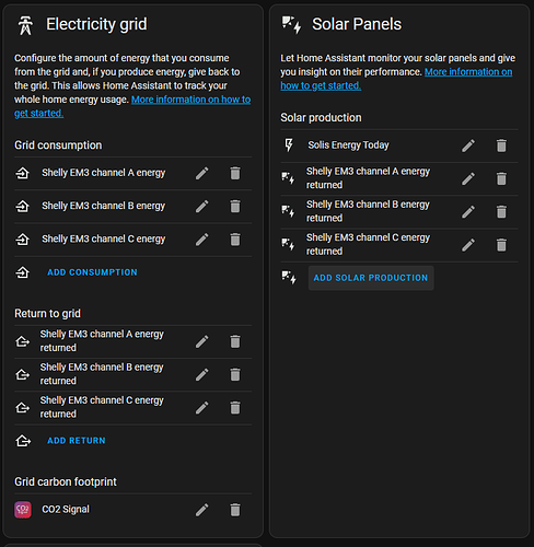

Hey Everyone,
quick rundown of my setup
shelly 3em monitoring 3 phases input/return
solis inverter w/5kw system returning solar stats.
my issue is that when i have my energy config set to the shelly being the input/return and the solis inverter being my solar imput, it assumes all return data is exported to the grid and not self-consumed.
if i add the return lines from the shelly 3em as solar inputs, the self-consumed data corrects itself but of course my solar stats are presumed to be double what they actually are.
is there some way im missing to correct this self consumed solar whilst also having the solar stats appear correctly?
