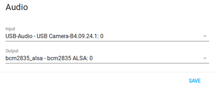

The screenshot of what I had before upgrade:
