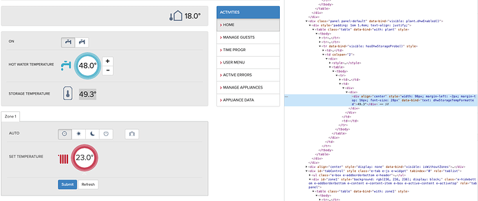

This provides a value back as expected. But the issue is with some other values on the site which I can’t get displayed. The value I want to get is the temperature value as highlighted below:
If i use Copy selector I get:
#content > div:nth-child(2) > div > table > tbody > tr:nth-child(3) > td:nth-child(2) > div > table > tbody > tr > td:nth-child(2) > div > div > div

I think that the selector without the tbodys is correct, but that the value of the field is fetched by the browser after the initial request by a javascript request. You might be able to find this out by monitoring the requests in the developer tools of your browser.
If this is the case, you cannot scrape it :slightly_frowning_face:

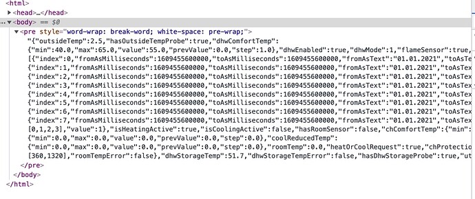

Ok, It seems I found the request:
The result is shown as:
{outsideTemp: 15, hasOutsideTempProbe: true,…}
dhwComfortTemp: {min: 44, max: 55, value: 48, prevValue: 0, step: 1}
dhwEnabled: true
dhwMode: 1
dhwStorageTemp: 49.2
dhwStorageTempError: false
flameSensor: false
hasDhwStorageProbe: true
heatPumpOn: false
maxDateAsText: "8/23/2022"
outsideTemp: 15
outsideTempError: false
todayAsMilliseconds: 1629669600000
todayAsText: "8/23/2021"
utcOffset: 120
zone: {holidays: [,…], mode: {allowedOptions: [0, 1, 2, 3], value: 1}, isHeatingActive: true,…}
Would that kind of work with the solution you have in mind? At least this response shows me all the values I am missing at the moment :slight_smile:

The problem is that the output is shown as text / no selector-copy functionality (only getting “body > pre”). Do you know a way with value_template or something else to extract something out of the following picture e.g. “outsideTemp” at the beginning?
