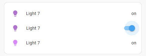

See no issues here.
type: entities
entities:
- type: custom:template-entity-row
entity: light.balcony_ceiling
- entity: light.balcony_ceiling
active: >-
{{is_state(config.entity,'on')}}
There is only a difference between “w/o active” & “with active” cases in part of some opacity mask.
Same as yours for my test
