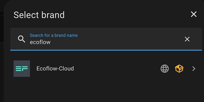

  1. settings/devices/add integration/

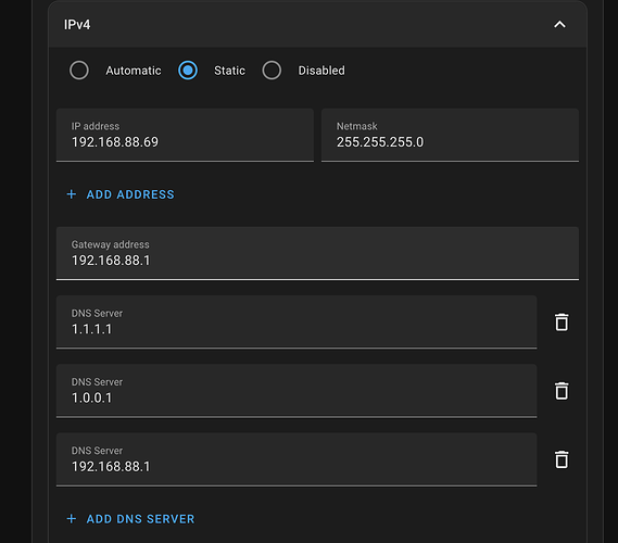

In my case the removing of router ip as DNS server and adding google DNS servers was help
My initial configuration included three DNS servers, one my ISP provided (primary), plus two Google DNS servers 8.8.8.8 (secondary) and 8.8.4.4 (tertiary). I tried removing the DNS server address provided by my ISP and only used the Google servers but with no change in the errors I was receiving. I then tried using only Quad9 IPv4 servers 9.9.9.9 and 149.112.112.112 but still no change. I confirmed from the core command line (via Terminal & SSH Add-On) that I can ping files.pythonhosted.org (domane name resolves to 199.232.36.223). I tried the same ping from the bare metal HAOS command line also getting a good response. I’m assuming I may have a different issue but with similar symptoms to those being discussed in this thread. I’ll try entering this as a new topic with all of my setup and configuration details. Maybe someone will spot an issue with my configuration.
revert order on DNS, please
example:
