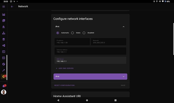

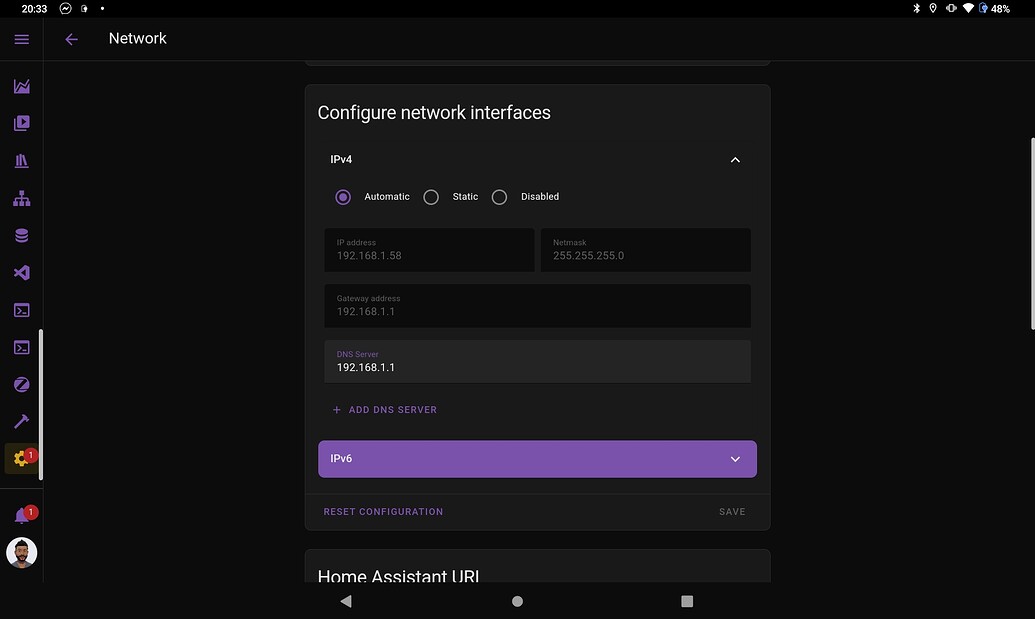

Managed to fix it
Well I am finally home and clicked the [Reset Configuration] button mentioned above.
Above where?
You will see it in this screenshot
just below ipv6
Thanks, it worked for me.
