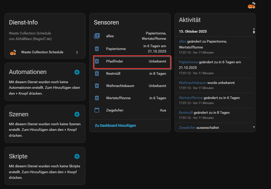

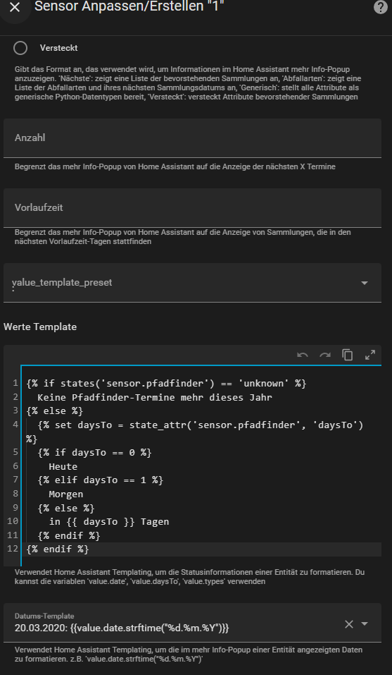

I’ve created a sensor within the integration. Currently, there are no upcoming data entries for this sensor in the foreseeable future anymore (in 2025). As a result, the sensor is shown as “unknown.” However, my template is being ignored and still displays “unknown.”
Sensors:
Template for Pfadfinder

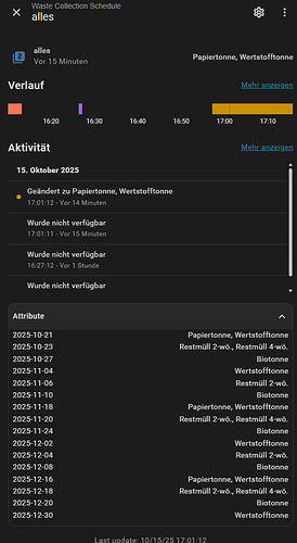

all upcomming dates for 2025:
“Pfadfinder” and “Weihnachtsbaum” can be selected from Types, so they are in the calender! Once the provider has created the calender for 2026, “Pfadfinder” and “Weihnachtsbaum” will be there again.
Any ideas, how can I fix this?
