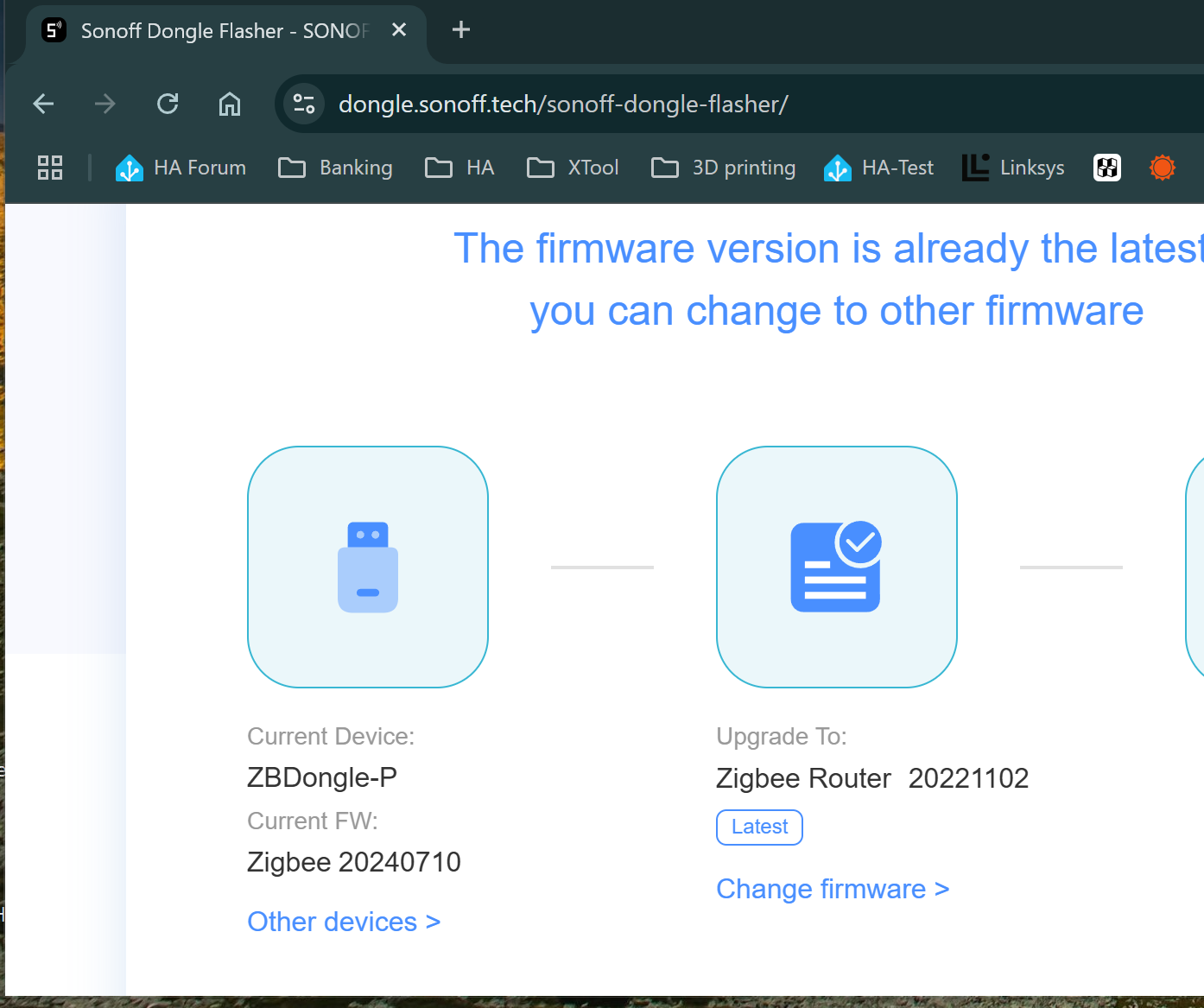

FYI. SONOFF has launched an online firmware flashing tool called SONOFF Dongle Quick Flasher , which supports ZBDongle-P and ZBDongle-E .
SONOFF Dongle Quick Flasher: Effortless Firmware Updates in 1 Minute - SONOFF Official

I tried this with my ZBDongle-P on Windows 10 which recognized it on COM4 but the Quick Flasher didn’t see it on COM4 at all. I want to flash it to router from coordinator
Thoughts?

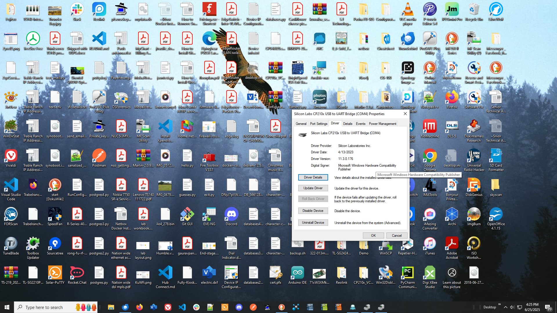

It needs the Silabs driver for the flash process to work, not just the standard Windows default driver.
I mentioned it only because I ran into the same issue.
I downloaded the VCP driver and got this:
Does this look correct?

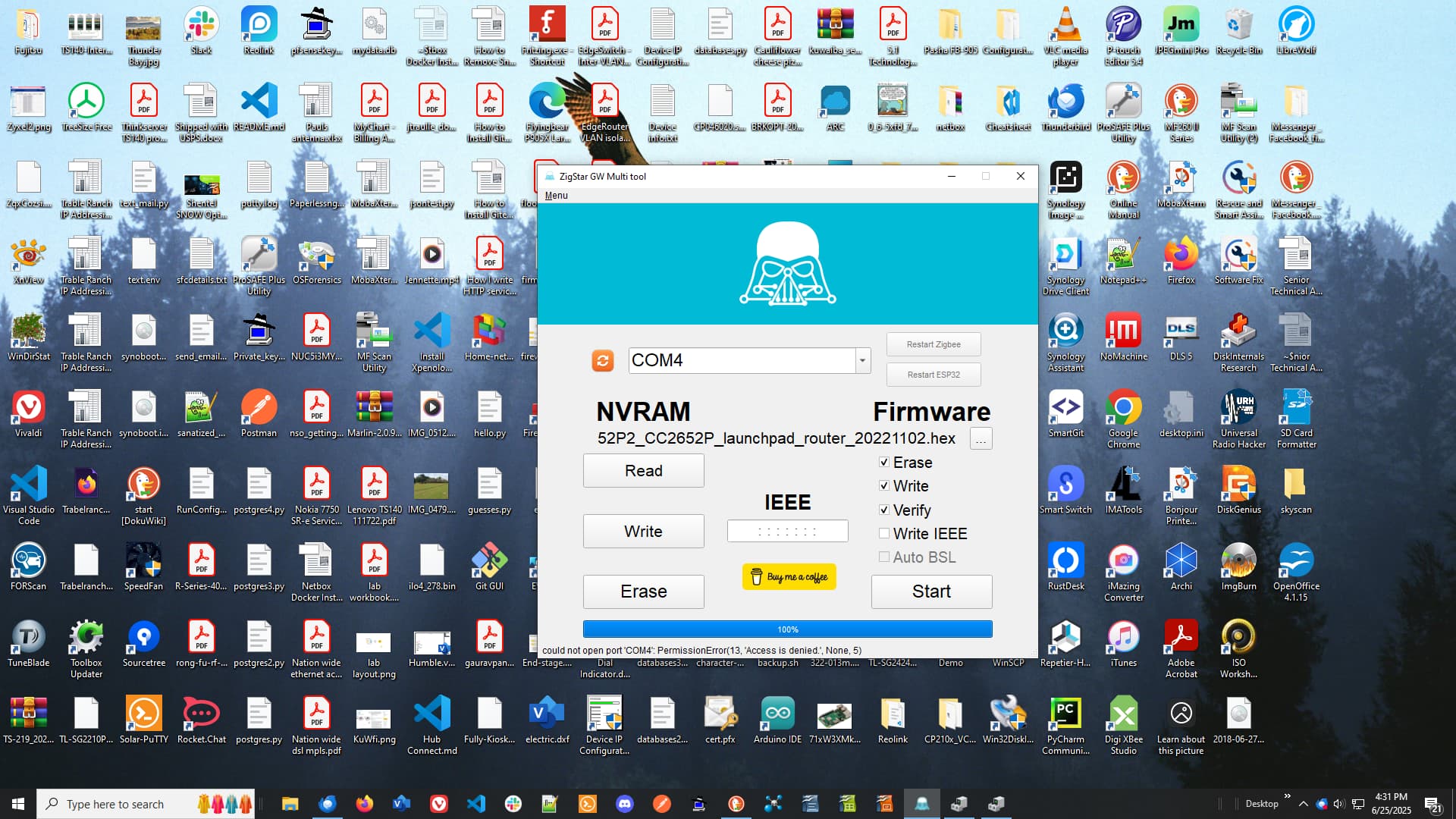

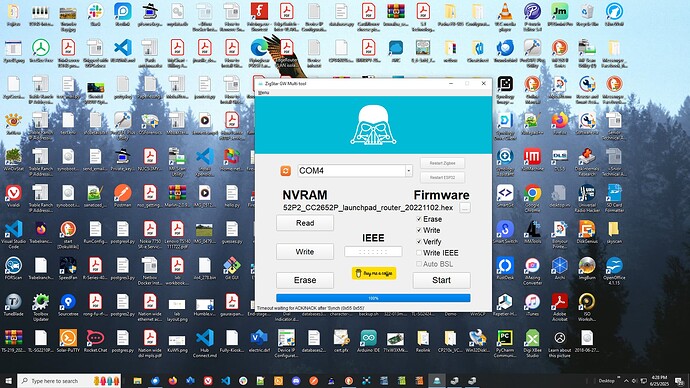

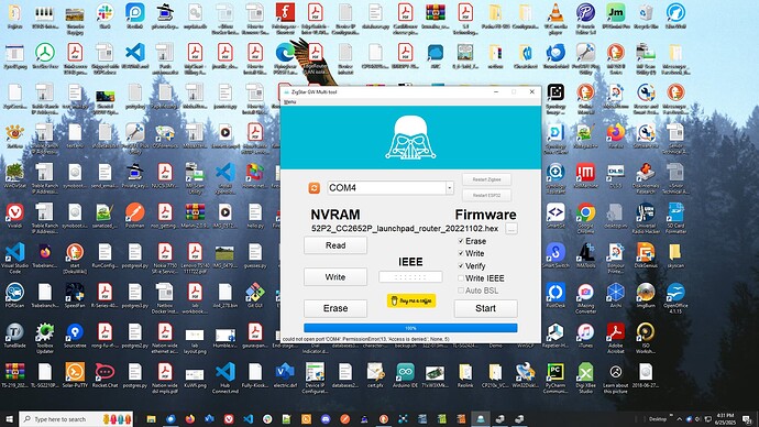

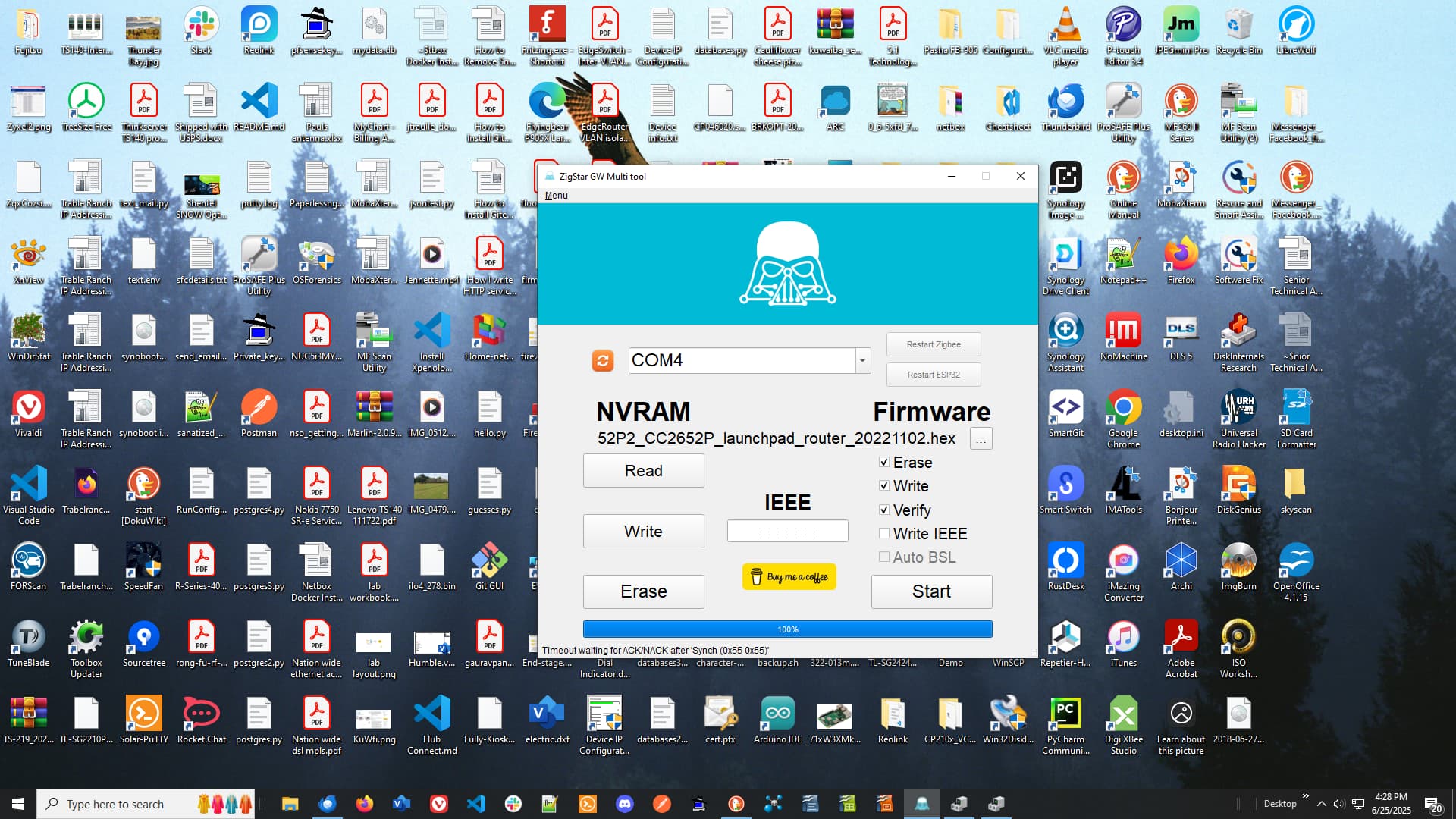

I also tried this:
I can access the Dongle P on COM4 and read, write, and verify the NVRAM but it fails to update the router firmware as you can see from the bottom status message here:
Thoughts? Thanks.
Where did you get the flash software? Sonoff has an online browser flasher. The link is earlier in this thread
I’m aware of the Sonoff on line browser flasher. I tried it several times and each time it would not find the Sonoff ZBDongle-P com port. I think they only set it up to work with linux.That’s why I switched to Zigstar GW-MT. It actually found the Dongle on COM4. It also read the NVRAM contents.
I downloaded the router software from Koenkk’s github site.
Thanks.
If you encounter issues flashing with the SONOFF Dongle Flash Web Tool, you may attempt flashing via Home Assistant’s Add-on:
It definitely works with Windows 10. I have used it multiple times with both the P and E.
Test other USB ports. I always use a USB port on the back panel.
