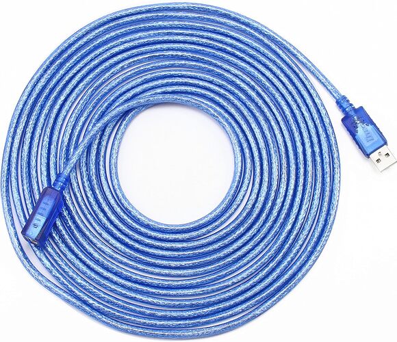

  • Use a long USB extension cable to place the Zigbee adapter away from interference and obstacles
  • Ensure the USB extension cable is adequately shielded (thick cables usually have this)

Is there any problems using a USB 3.0 extension cable when it is connected to a USB 2.0 port?
There is no problem since USB cables are backwards compatible, in fact it is usually better since USB 3.0 cables are normally betted shielded. USB 3.0 cables have the same numbers of wires/pins so in practice the only difference is just that they are better shielded. Shielded cables are better to use for radios and long cable lenghts.
Other than better shielding USB 3.0 cables also have lower resistance and use thicker gage so can therefor be rated to transfer more power and higher data rates but that only matter to USB 3.0 devices and not to USB 2.0 devices.
Thank you,
I know of the backwards compatibility (since it is what I am currently using). It was mostly if a usb 3 cable connected to usb 2 port could create EMF interference similarly to if it was connected to a usb 3 port. But I guess not :slight_smile:
My external SSD is connected to usb 3 port though. I have shielded that cable in tinoil to minimize the interference.

Zigbee interference caused by USB 3.0
A lot of users build their smart home around a Raspberry Pi. It's quite popular to expand the storage using an external hard drive connected to the Raspberry Pi via USB 3. What most users don't know is that USB 3 causes enormous interference with any Zigbee device or stick that comes close, to a point that it no longer works.
Gabriela recently joined the Nabu Casa team as a technical documentation writer and has been focusing on documentation to help users avoid common pitfalls like these. She updated the documentation for the Home Assistant SkyConnect including this 30 second video that shows how bad the issue is:
The advice already posted above in a this thread stands as my recommended guidelines for general best practice, and as you can read there my recommendation is that it is better to have many good Zigbee Router devices than a just one or two great Zigbee Router device(s).
